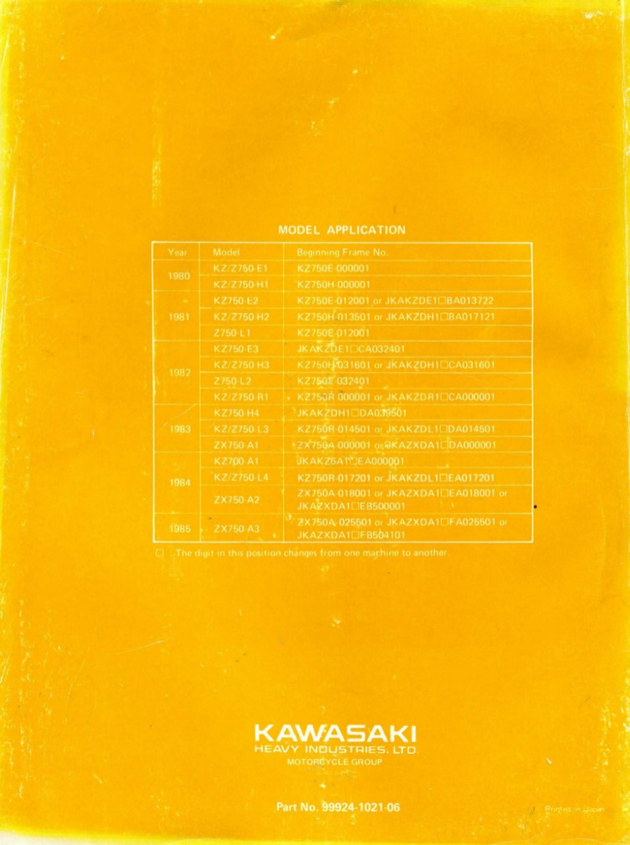

30 Mar 2022 20:18 - 30 Mar 2022 20:23You need to get a copy of the factory service manual. All of the answers are in there. There may be a PDF copy in the Filebase on this site.Do you know if it has a torque spec or needs Teflon tape?
Here is one that covers your bike: ebay.com/itm/132106687961
EDIT: Found the PDF in the filebase: kzrider.com/filebase/download/17-kz750/1...e1-h1-service-manual

30 Mar 2022 22:37 - 30 Mar 2022 22:39You need to get a copy of the factory service manual. All of the answers are in there. There may be a PDF copy in the Filebase on this site.Do you know if it has a torque spec or needs Teflon tape?
You get eye cancer from this service manual, it´s a really bad copy. You better use the colored one from 750turbo.com.
www.750turbo.com/manuals/GPz750_Base%20Manual.pdf
