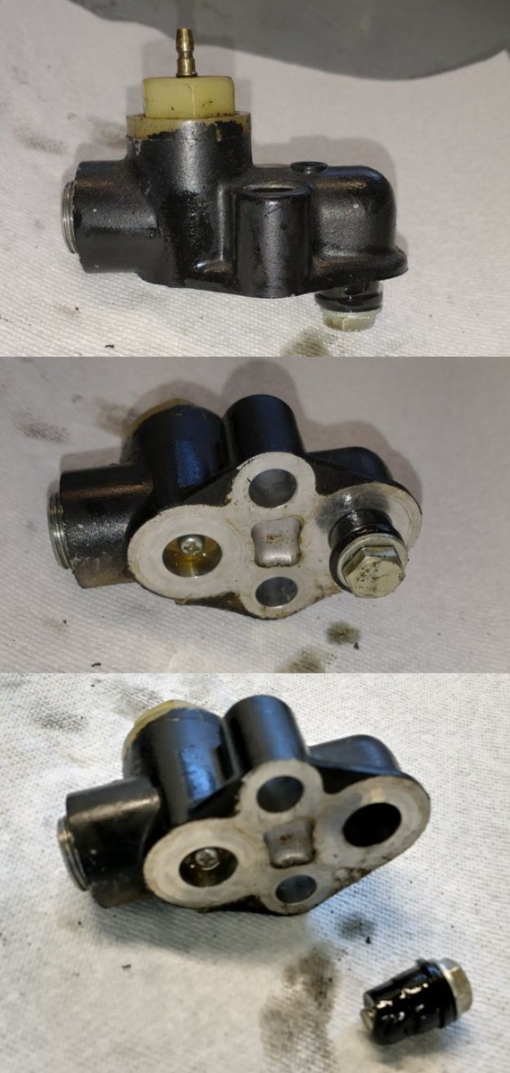

I just found the cause!!
A plug is installed in the small housing under the carbs!
This is the remaining of a Lockhart oil cooler.

Glad you found the problem. Funny thing someone else had the very same problem on facebook.

Never seen a plug like this in the oil pressure switch housing. Looks like some stupid mechanic try to rise the oil pressure and block the oil port to the cam bearings. This plug looks like a rubber well nut for the wind screen.

I guess at some point it ran an external oil feed to the head and cooler. Take the positives from it Claude, your oil pump is a monster and the rest of the seals must be good or it would be like a lawn sprinkler

31 Mar 2022 09:18 - 31 Mar 2022 09:20Scirocco, this plug looks to be part of the aftermarket oil cooler (Lockhart) that was installed on this bike when I bought it. It is said to block this passage to redirect the oil flow through the galley plug on the RH side of the engine where one of the oil cooler line need to be installed.Never seen a plug like this in the oil pressure switch housing. Looks like some stupid mechanic try to rise the oil pressure and block the oil port to the cam bearings. This plug looks like a rubber well nut for the wind screen.
Strangely enough, among my spare parts, I do have another "oil housing" that have the same rubber plug in the same hole. It also comes off a bike that had an aftermarket oil cooler on it.
