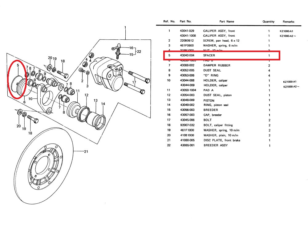

UPDATE : FInally got htis bad boy back up and running. Turned out IT was the rusted battery leads. .....I ended up having to take it into my local shop and had them replaced with what i ordered online. They Sync'd the Carbs for me and I am back on the road! I do have a little issue with my right Brake Calipar. I'm missing the SPACER (part 43040-004) that goes up aginst the PAD and because its not there I have a rattle. I've got a makeshift one in there but if anybody knows where I can find that part? I'm finding it unavailable everywhere I know to look.

He sells the spacer #43040-004 you needed.
z-fever.de/shop/en/product_info.php?info...ibe-bremssattel.html
