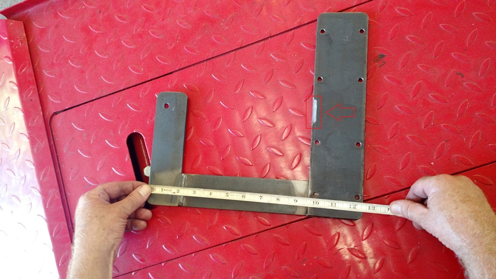

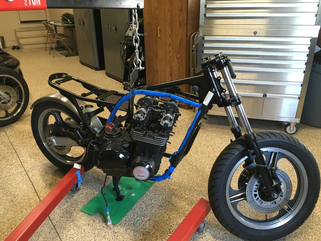

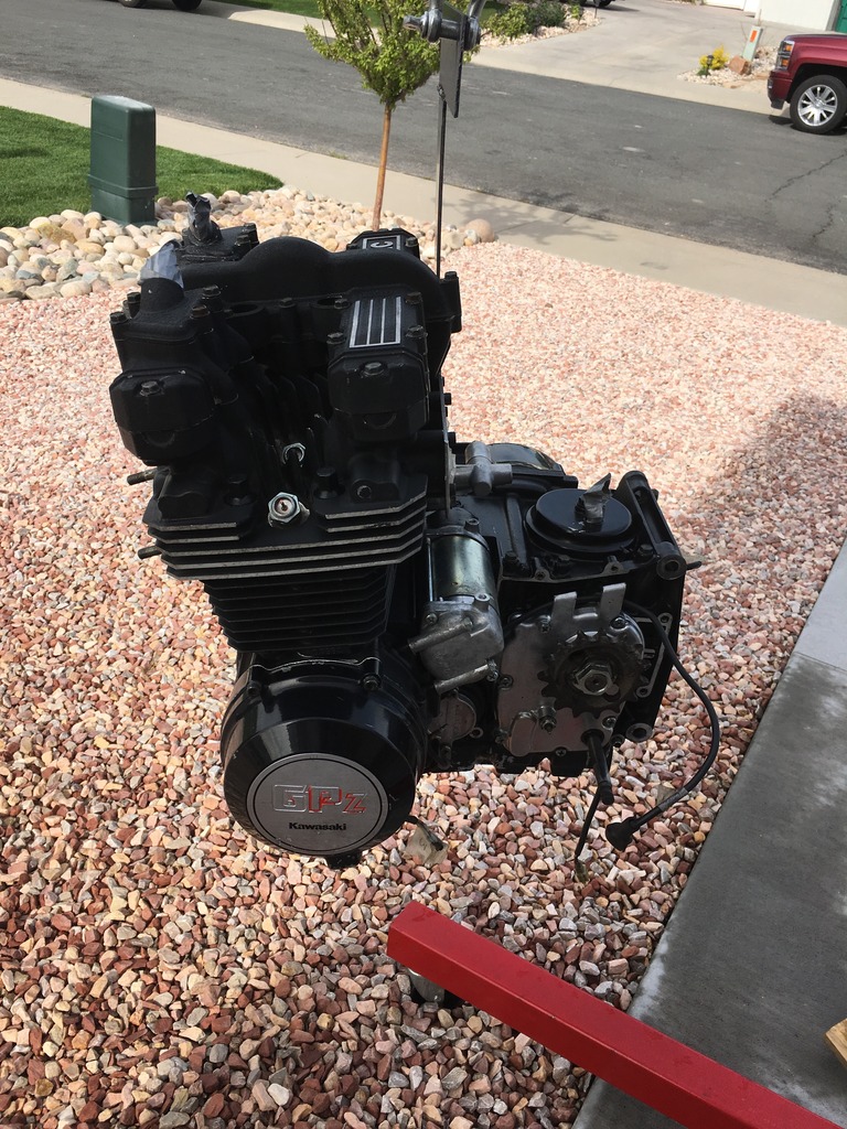

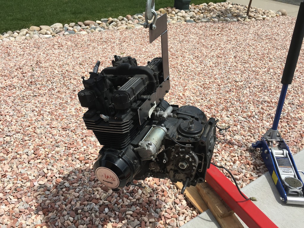

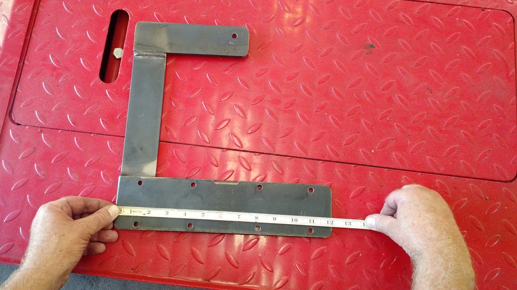

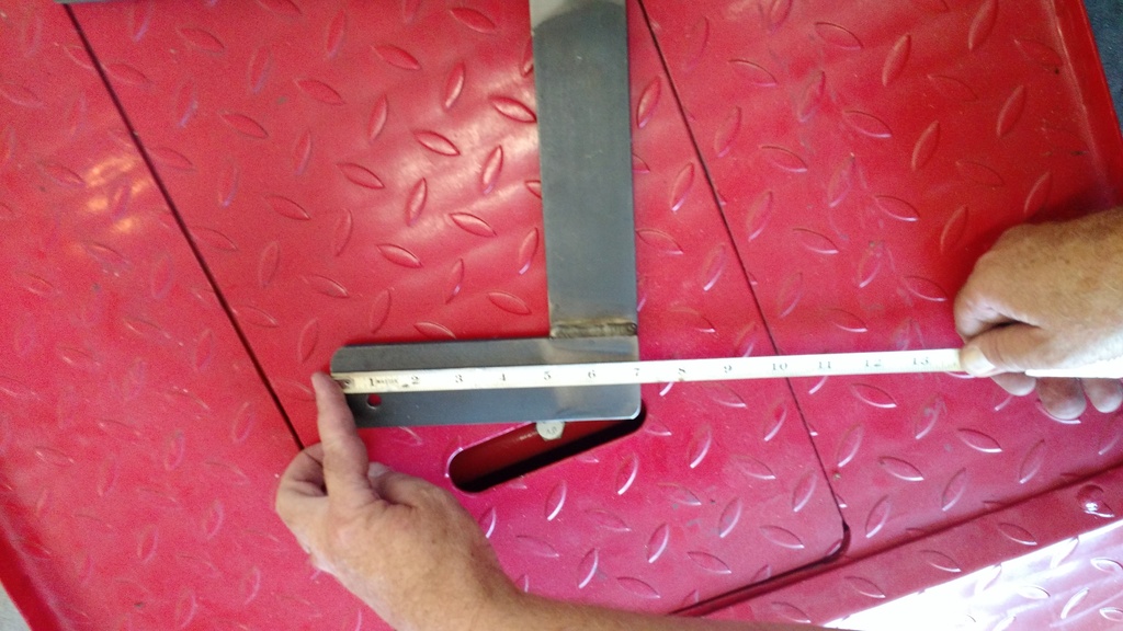

I made a lifting device that bolts to the intake with 8 bolts with a handle on teach side to allow the engine to be installed without damaging the frame paint.the left side is longer to allow it to extend through the frame when installing the engine. I wrapped rags around the frame and used tape to hold them in place. I then removed the valve cover, drain plug and oil filter to give a little extra space to slide it over the lower tube of the frame. I then had two friends set the engine on a floor jack. I positioned a scissor jack under the frame and adjusted it to allow us to set the motor on it once we have it in the frame. We raised the floor jack to the proper height and rolled the floor jack so the left side handle was through the frame. With a guy on each side we lifted the engine, set it on the scissor jack and adjusted the engine height and installed the mounting hardware. No scratches!
