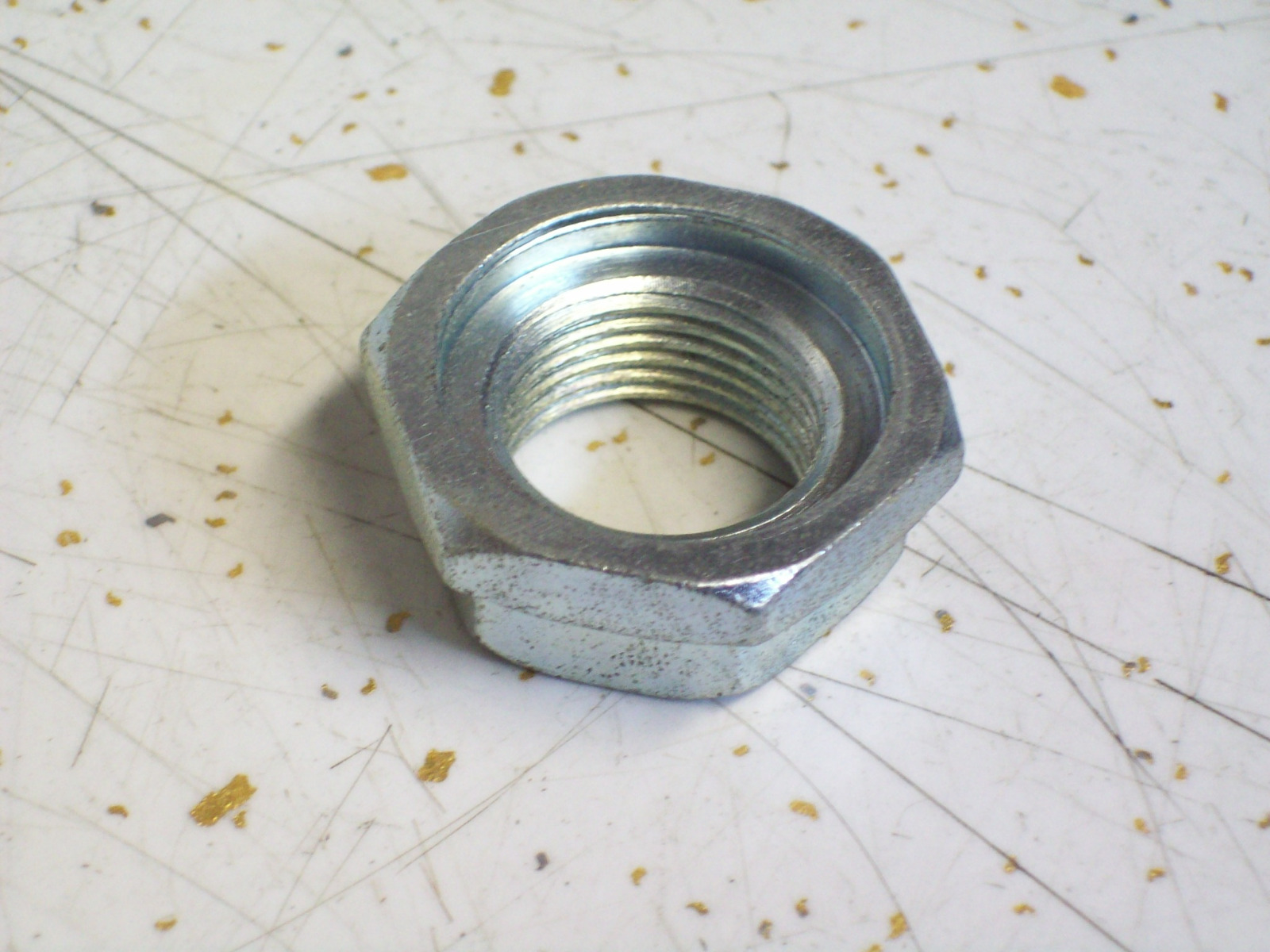

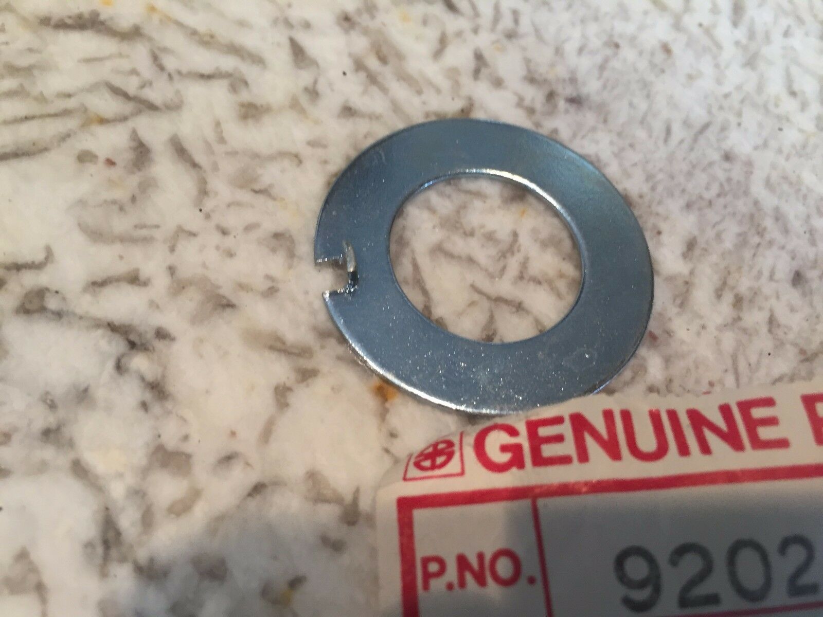

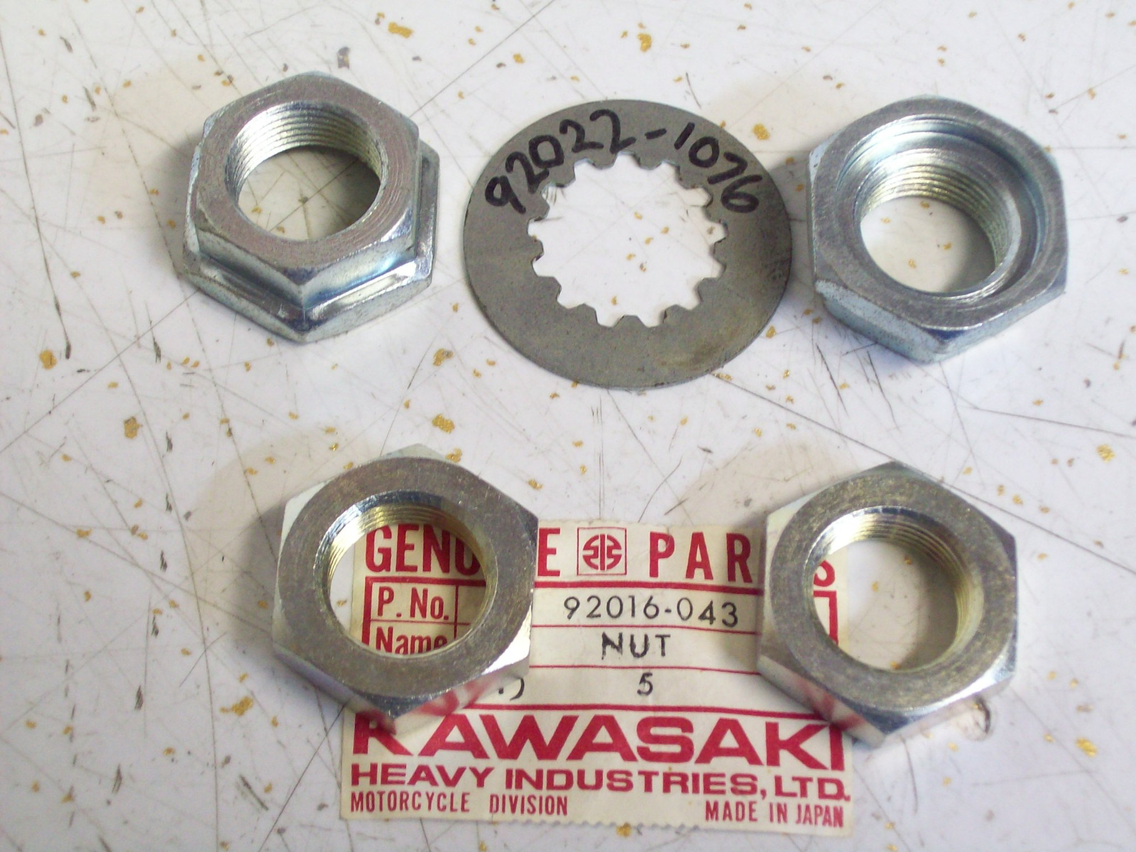

The Kz900 and the '77 Kz1000, and early '78 model year Kz1000 have a different O.P shaft than the late model '78 Kz1000's and later Kz1000's. The late model O.P. shaft has the splines fit all the way through the counter sprocket. That O.P. shaft uses the nut with the shoulder and the lock tab that has the spline pattern on the inner edge. The shorter Kz900 O.P. shaft where the splines do not reach the outer edge of the counter sprocket uses the regular looking nut with the locking tab that has the little nub that fits into the tiny hole on the counter sprocket. The counter sprocket nuts and locking tabs are not interchangeable.
Here are both style counter sprocket nuts and the later style lock tab.
Better photo of the backside of the later style counter sprocket nut with with the shoulder.
The early style locking tab that is used with the non-shouldered nut on the shorter Kz900 O.P. shaft.

Thanks everyone this tap washer fits and do or some reason on tightening the sprocket went deep onto the splines I think the shaft came out a little further
