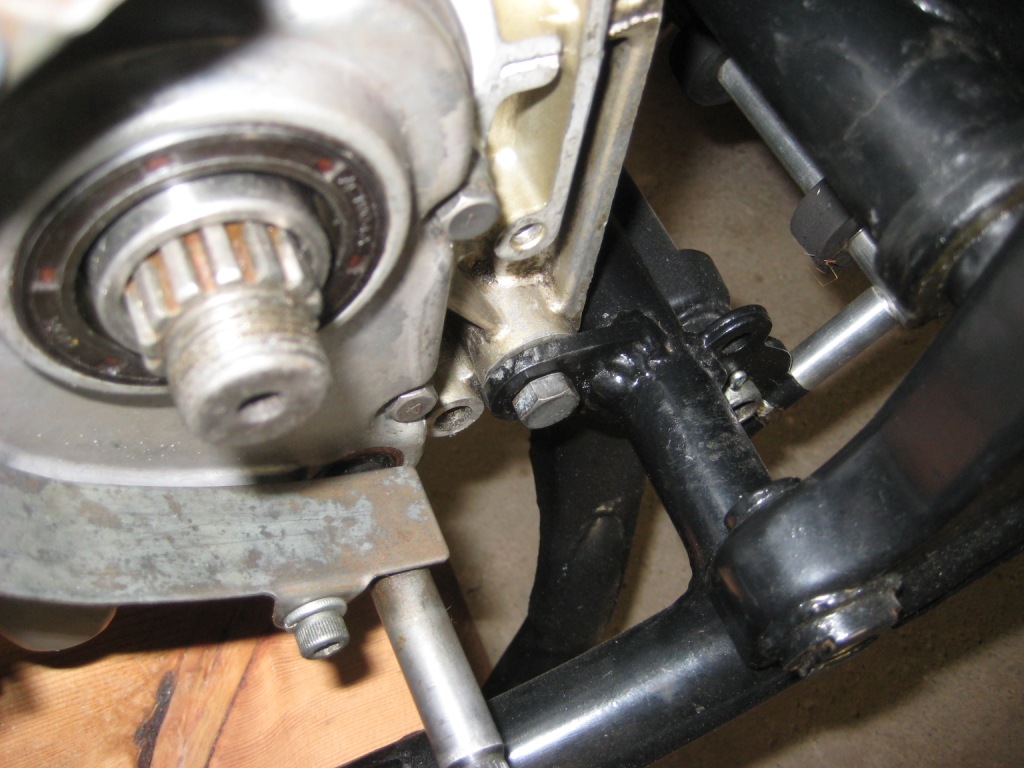

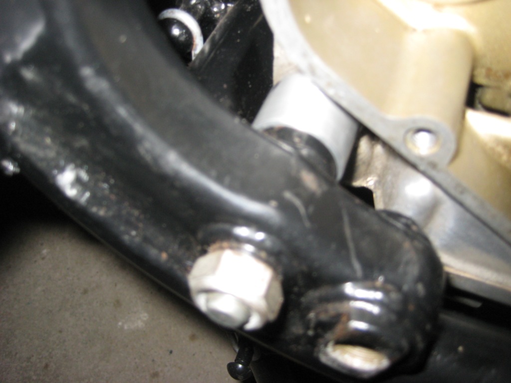

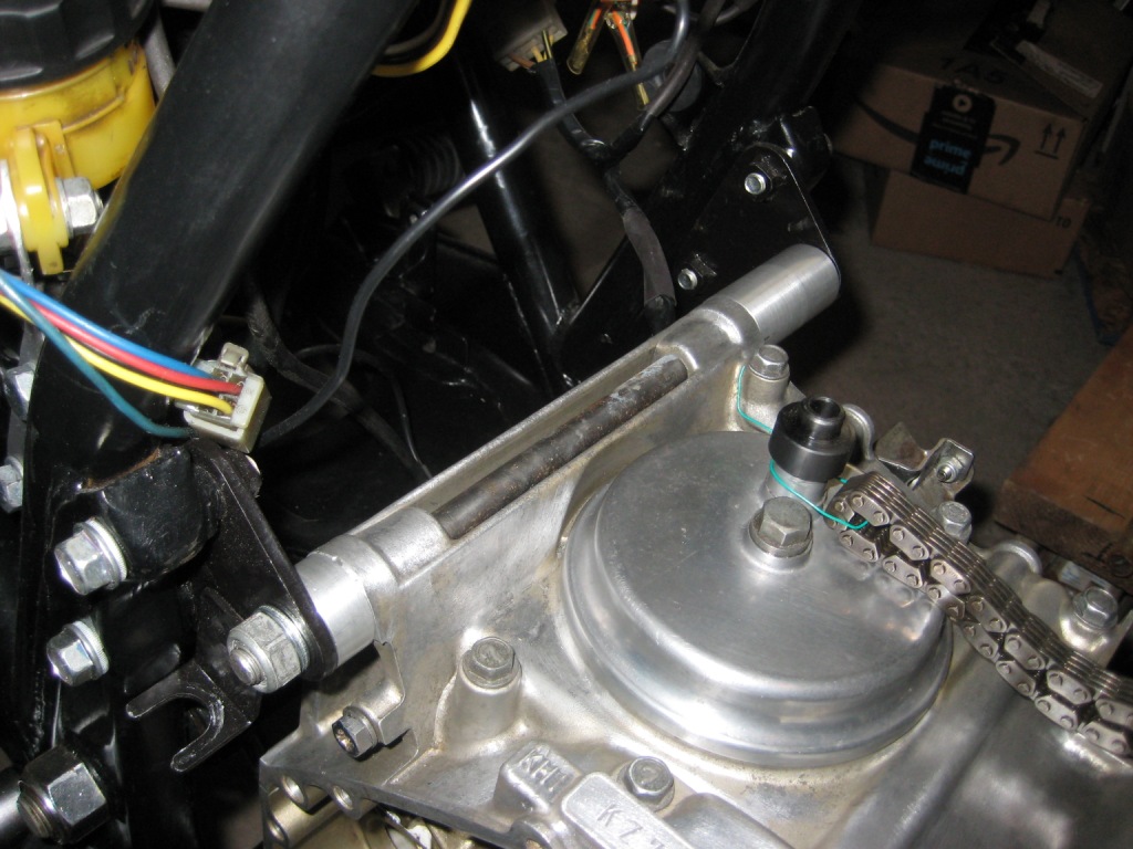

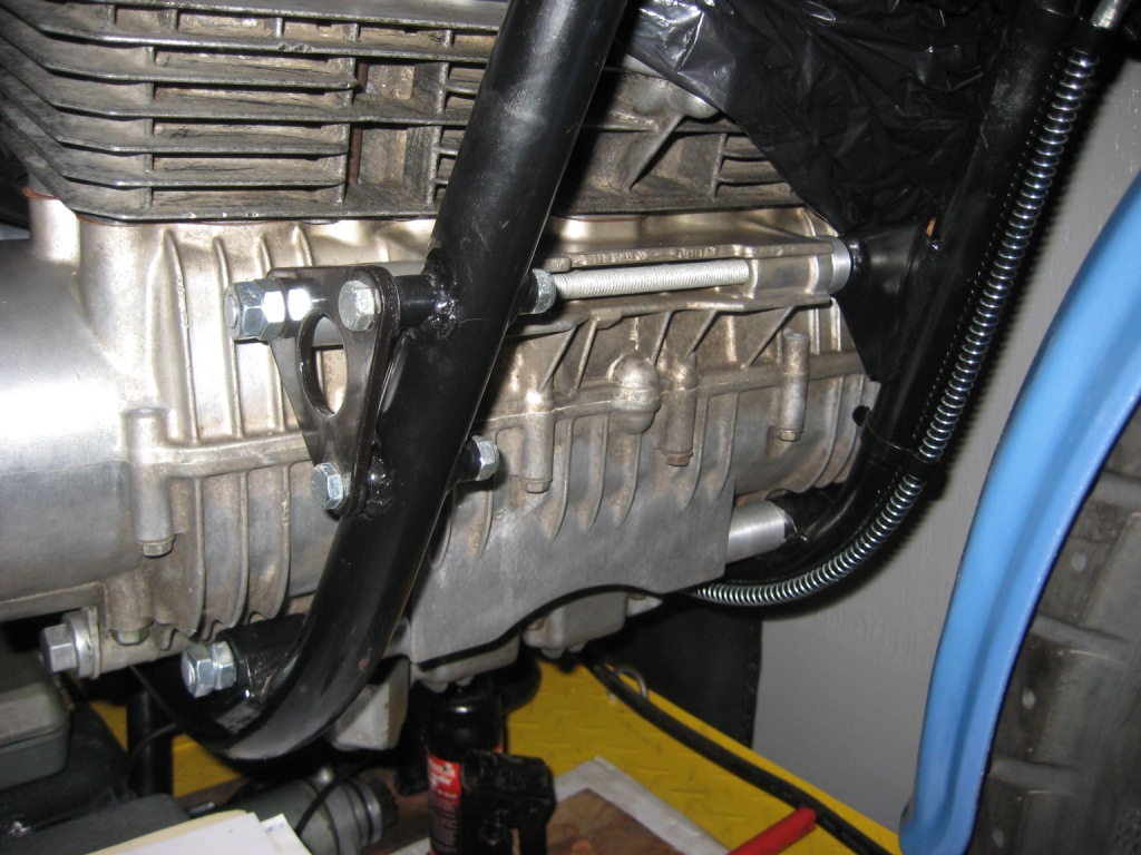

I did the same thing only a bit different. I put a '82 750 Spectre motor (originally rubber mounted) in a KZ650 frame. You end up having to make up the rubber mounting space with aluminum spacers. This has to happen at every engine mount face. The spacers I made are 6061 aluminum, faced to length on a lathe then drilled for the engine mount bolts.
The key is bolting up the motor using all the motor mount plates to suspend it and carefully measuring for the missing spacers. The lower rear frame mount tab under the sprocket needs to be maintained tight to be sure the chain lines up.
There is no difference in ride from a normal rigid mounted KZ.
The original Kawasaki rubber mounting system is a bit complex to try and retrofit onto a solid mounted frame - Way too much work involved.
