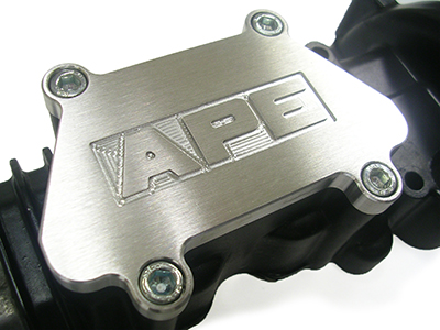

On a basic level you can simply run a hose to link one reed chamber to the other if you have the original caps or just fit blanking plates similar to the ones in attached pic.
Either will cause no issues.
