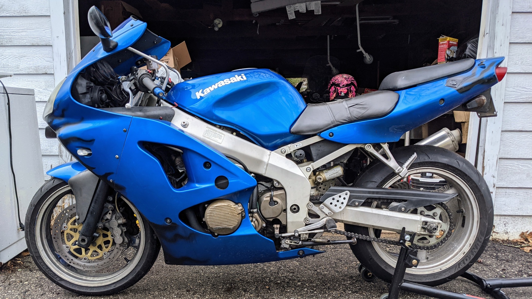

Hi, so, when I hit the starter it turns over fast, but then hits a point and stays there - pressing the button again just makes a brief straining sound.
If I put the bike in first then rock it back once or twice, it starts just fine - if I rock it back before I try starting at all, works fine too. My first thought was gas in the cylinders, but my oil level is stable and it happens if I turn off the petcock, and it happened whej the carbs were totally drained.
Confession: I'm talking about my recently acquired ZX-6R. I hope you'll have some ideas despite that. Coolant level seems the same, but maaaybe it's leaking into the cylinder? Can't see down the spark plug holes without a probe camera. I'm also wondering if it's a weak starter or battery - new good quality battery but you never know. It starts fine once I get it going, whether it's warmed up or still cold.

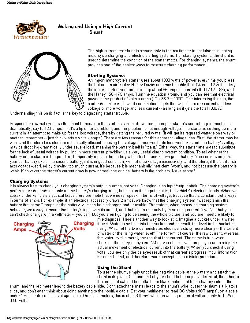

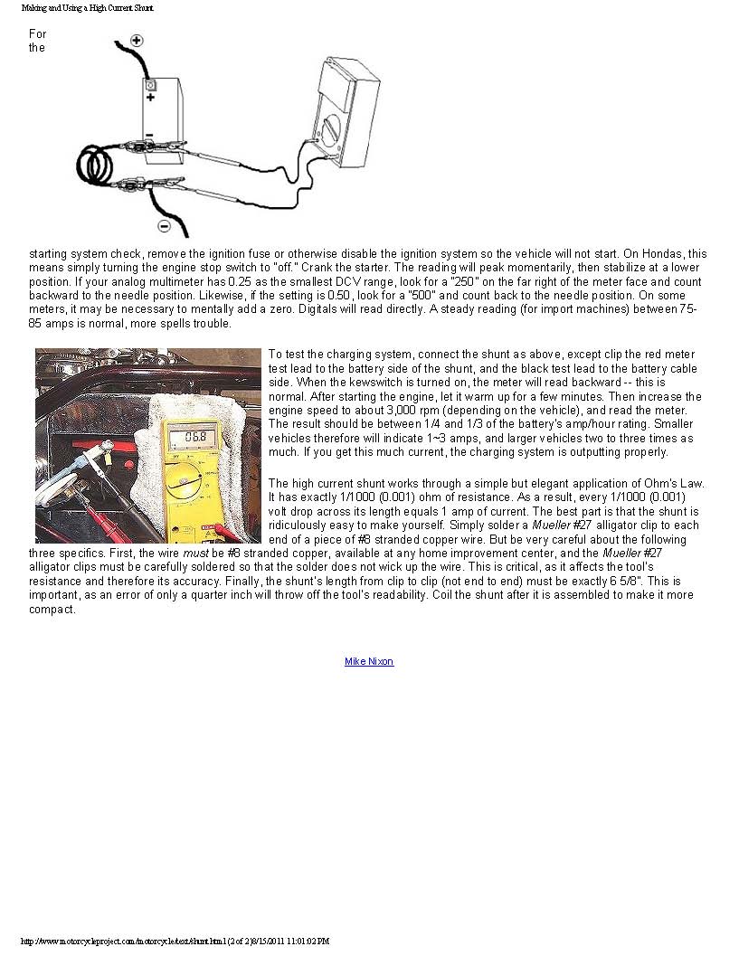

As streetfitgher indicated check the battery and connections as they are pretty easy to check. Second it could be the starter clutch, which makes a rather distractive sound. I am sure that I am not telling you anything you do not know, but the starter system is by far the largest draw on the electrical system. At this point I would put up a link to a page on the motorcycleproject.com about making and using a high current shunt. But that page is no longer active on the site. I pulled down this pdf from there in the past and converted it jpg files it makes sense to me and appears to be easy to make and use. Using it will tell you if it is a battery or starter issue. To use it does require a VOM. Anyway here is what was there in the past.

The info from gd4now is very useful. I like the idea of making a shunt to measure the battery current.
It seems like the key point would be to figure out if the current is very high or fairly low during that time when you say it "just makes a brief straining sound."
If the current is very high, the starter and starter clutch are likely working correctly, but the crankshaft is mechanically stuck or blocked by something. This would be bad, I'm pretty sure...
If the current is low, then you could have an issue with a number of components, such as the battery, starter (brushes, commutator, etc.), starter solenoid, some other electrical bit.

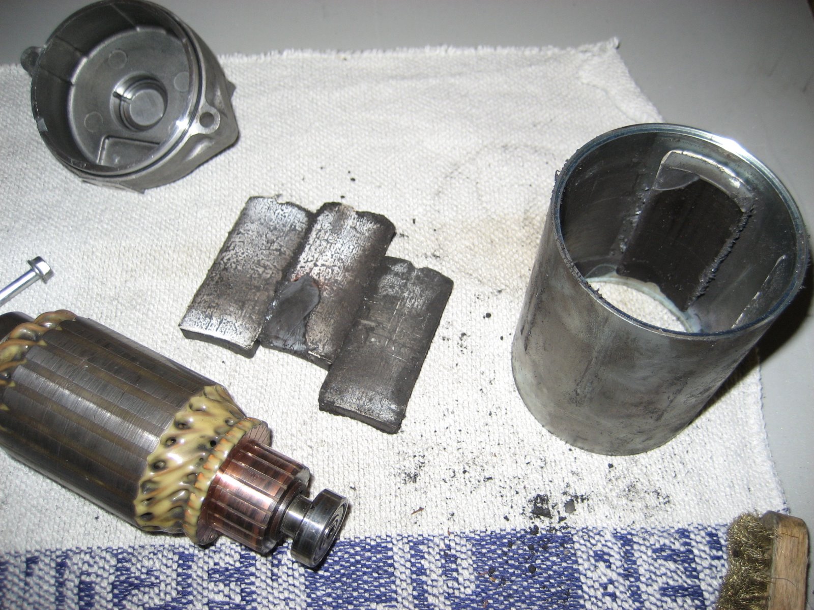

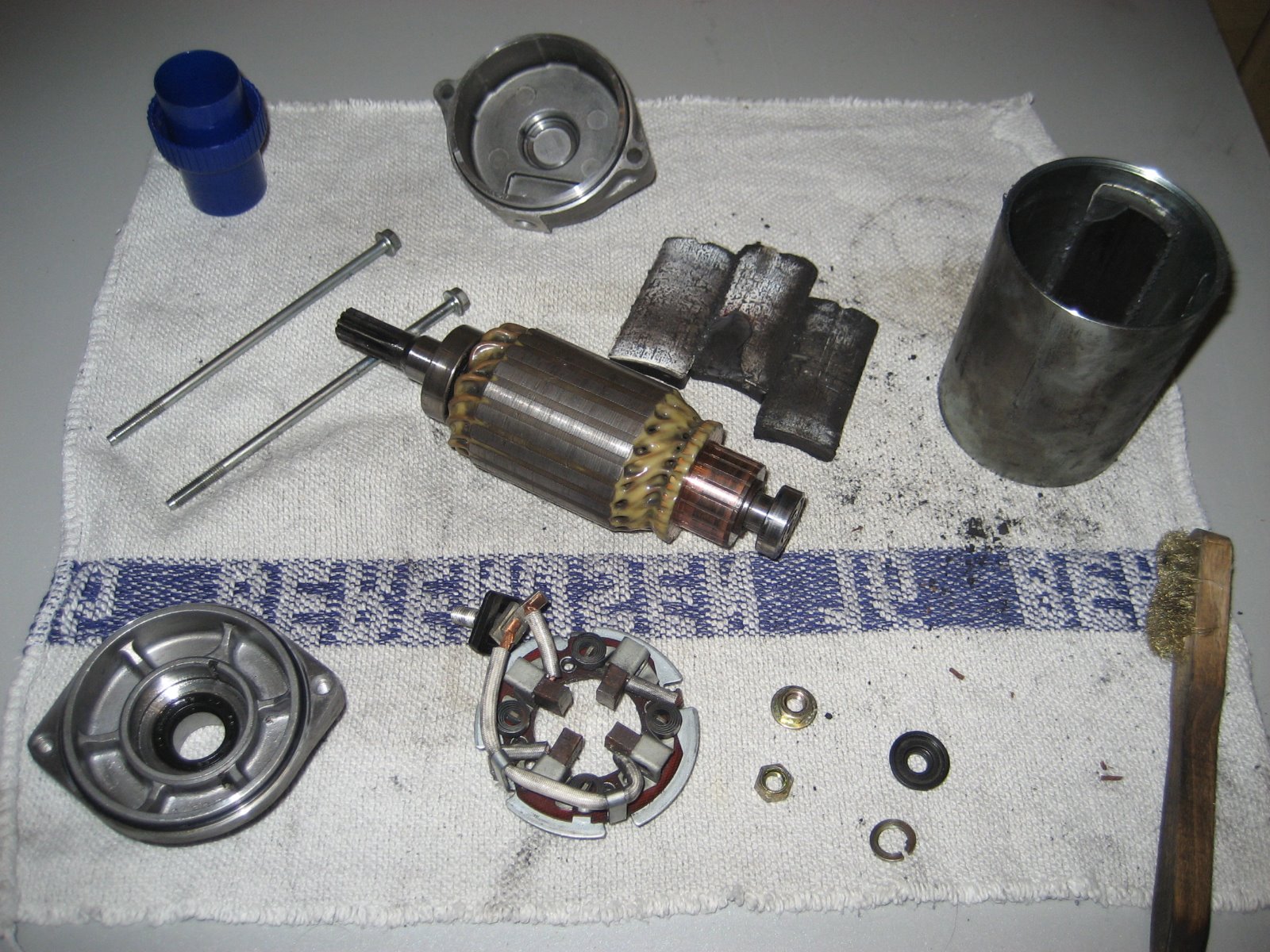

It´s not an electric problem!!! Had the same problem like you on my Hayabusa, new battery, jump starting, no way.
Three of four glued magnets broke loose from e-starter housing and block the starter rotor from turning over!!!

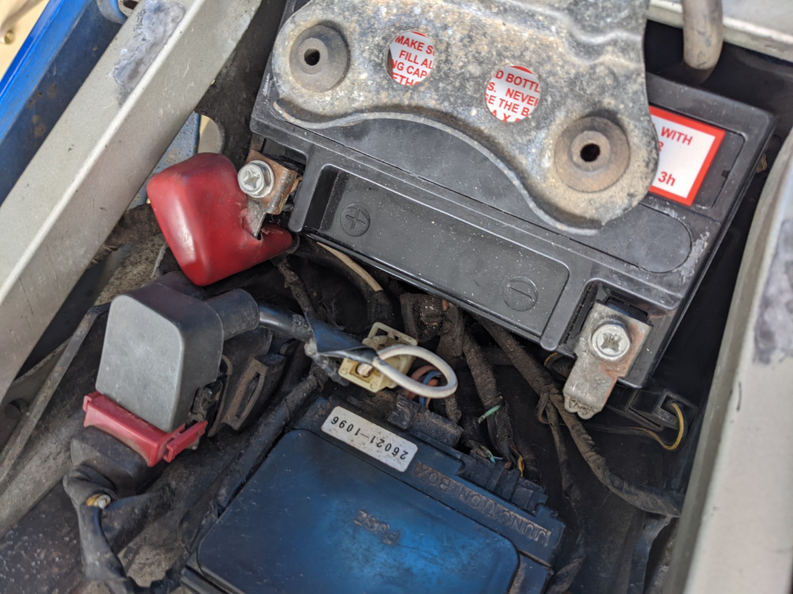

I noticed that the rubber cover for the positive terminal was off, so I put it back on and it starts no problem now. It feels too good to be true, hence my decision to check everything you've mentioned once it warms up a bit, but here we are.
Thanks again everyone. I'll update if anything changes or I find any other culprits.
