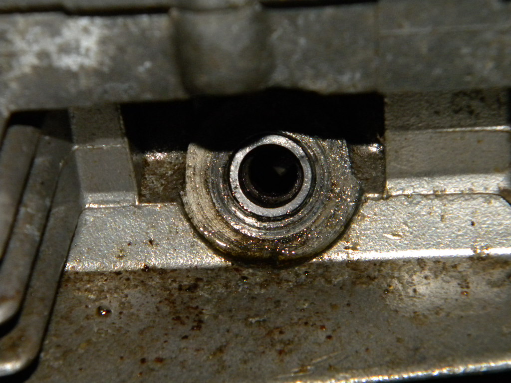

Well, it happened Again; I was hoping it wouldn't but it did. This bike has been outside for a looong time, and when I went to take out the spark plugs what I thought was a turning turned into a Crunch..!
Yes, BOTH spark plugs turned all right; that little silver ring is what remains of the spark plug threads; on both sides! If you look closely you can see the remains of the spark plug tip in the cylinder. It appears I have some work ahead of me. Any ideas for getting those out? I had soaked them in PB Blaster for a week and tried to use heat before I attempted to turn them, but they broke faster than Betty White's hip. It didn't take much.
Because of this I've back-burnered the KZ400 project until I can drop the engine and take it all apart, but I'm hoping somebody here has a solution...?

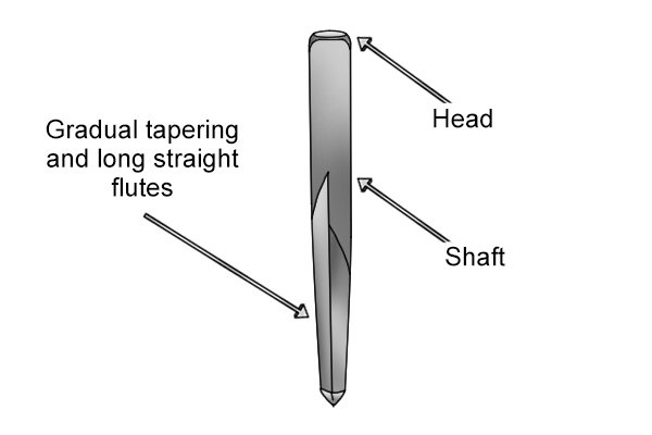

I'd try a fluted screw extractor; I struggled with a broken plug like this in a variety of other ways and none of them went anywhere - least of all a spiral-type extractor. If that doesn't work, I'd pull the head, I think that's the path of least risk of damage.

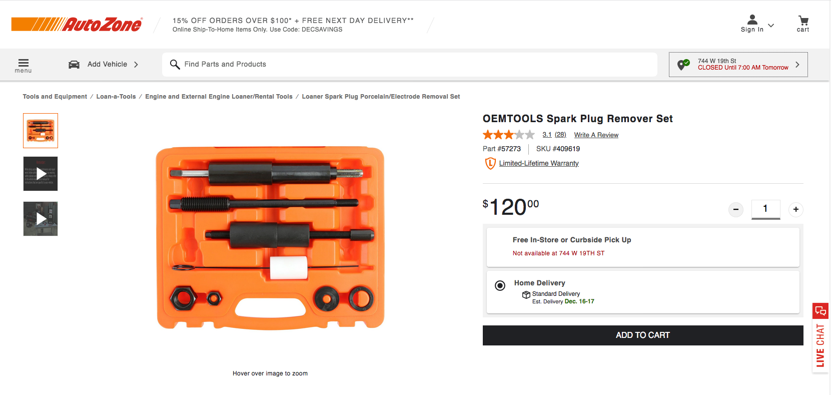

Check out Autozone's free loaner tool for a Ford Triton spark plug extractor.
It may work, but double check the clearances as the spark plug is a different size externally.
Ford trucks had a fun time breaking spark plugs so there was a tool created.
www.autozone.com/nuts-bolts-and-washers/...mover-set/409619_0_0

Update - I tried the pipe nipple removers, but no luck there; after doing some more reading I've ordered some square fluted screw extractors to see if that makes a difference. What really bugs me though is I managed to break off two cooling fins with the breaker bar!

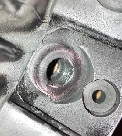

Drill out most of it!
EDM burn it out!
Research EDM ( electrical discharge machining)
Any and all of those e z out extractors are just going to push outward against the thread, binding it more.
Drill it out. put an insert back in!

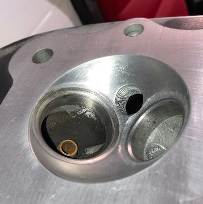

I had a plug broke off in a 79-80 smog KZ1000 head. It sat for 20 years! it was not going anywhere! I drilled down to the minimum, the just chisled the thin metal out that was left. Got lucky to just run a nice sharp 14mm tap through. Not a plug chaser. It looks ugly, but with 3/4" of threads! A new plug will work fine.
