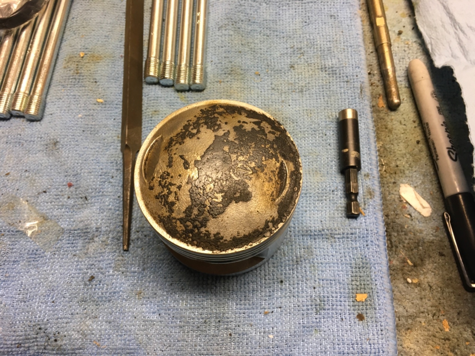

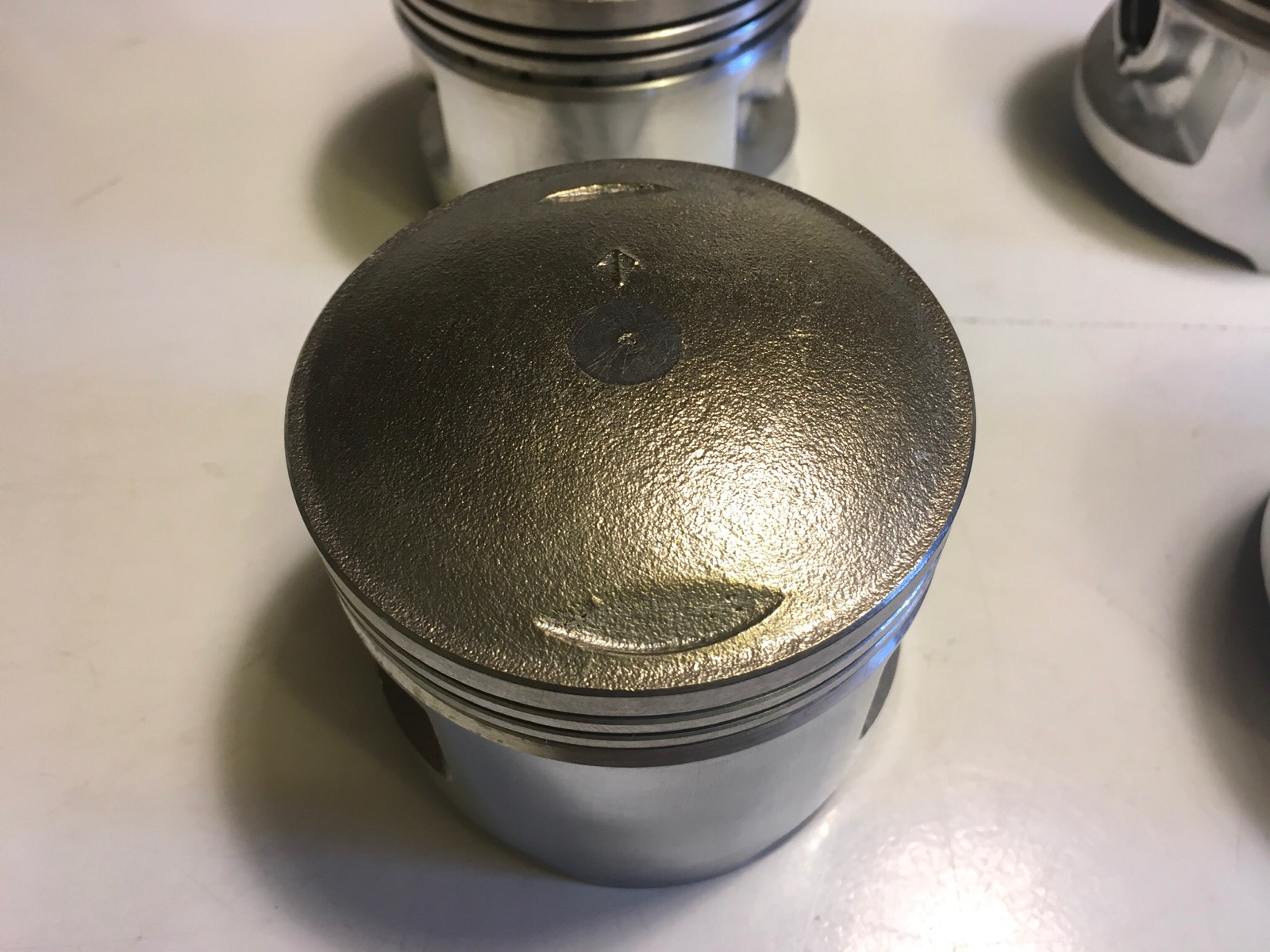

I’ve had good luck with Berrymans. As Nessism mentioned patients is your friend. Unfortunately I didn’t get a picture of these before I started. The fugly one is after a couple of soaks and gentle scrubbing with a brass wire brush. The clean pic is the finished product.

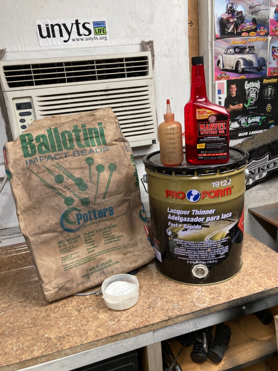

I started this 15 yrs ago here! Marvels Mystery Oil! Mixed with either lacquer thinner? Acetone or Mineral spirits!
I always used Lacquer because I had it as a painter! It does evaporate as it sits.
but only way! Scrub it off with nylon, plastic, soft abrasives!
then media blast with fine glass beads!
I’ve only been doing this for 40 yrs.
Carbon on Valves! Tops of pistons!
clean them 1st. Whatever? I’m old and done! Worked for me! You need Air! And tools & equipment! At least this is me! What I did for the past 45 yrs.
