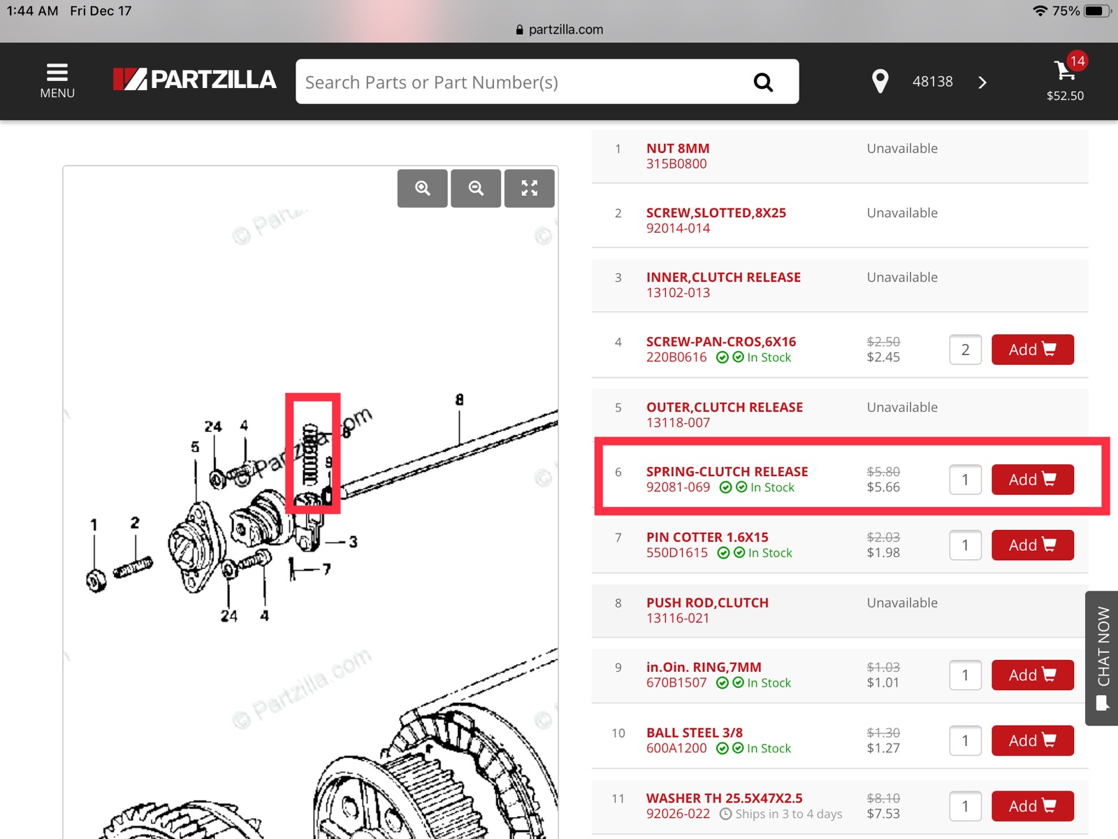

It was used on a lot of models, however, the part that the cable connects to evidently comes in two versions. One part number fits the 550s and 750 four cylinder engines, while the other number is listed for the 1000, 1100, and 750CSR twin. I wonder if one is a tad thicker than the other, thus requiring a different pushrod?
www.partzilla.com/product/kawasaki/13102...45e129b47a54be3be915
www.partzilla.com/product/kawasaki/13102...b98a997ab2f619aa19d9
