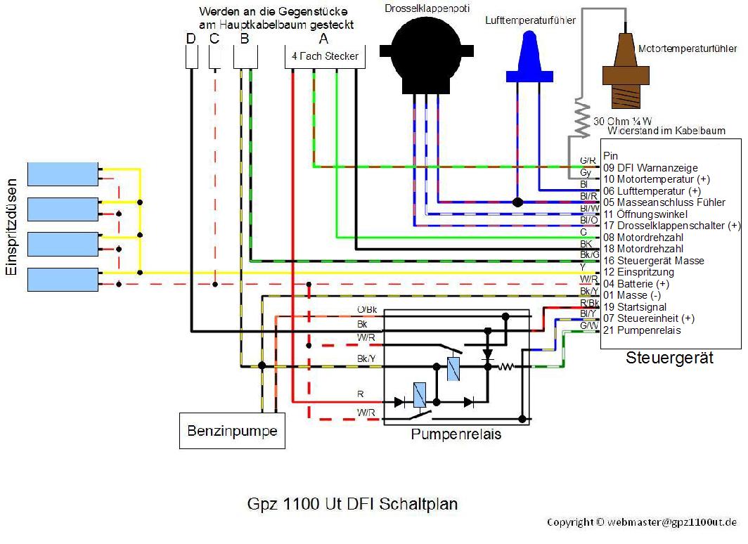

The grey wire of the engine temp sensor had an extra 30 OHM resistor in the wiring harness. He could be shot or give the EFI computer wrong values.
The following user(s) said Thank You: woodyvale

Thanks Scirocco, never knew there was a resistor between the sensor and the computer. Will check that out.

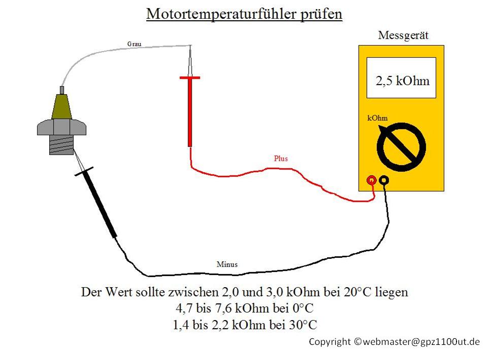

OK, checked the engine temp sensor as per sciroccos illustration. Measured 1.98ohms at 25C so I guess its within tolerance.
located the resistor in the dfi loom which measured 30ohms between its ends.

15 Nov 2021 04:53Measured 1.98ohms at 25C so I guess its within tolerance.
1.98 ohm, or 1.98 K-ohm (thousand ohm)?
1.98 ohm would definitely not be good.

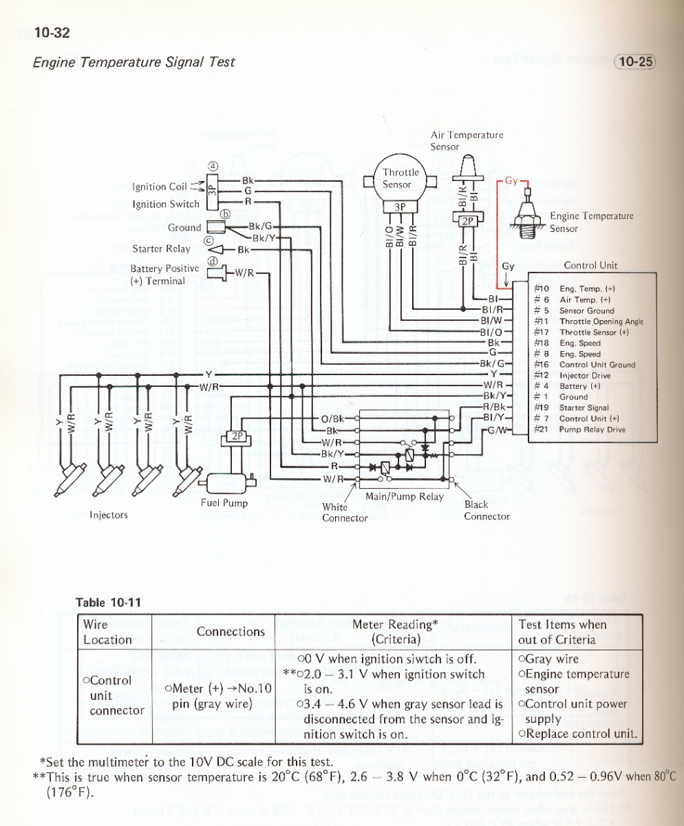

Here is the page from the manual for the temp sensor test. The error-code blink-chart points to this page in the manual. This test will confirm both the sensor and the control box are working, since it's measuring the voltage on the signal line.
Another thing to check is the ground connections. The temp sensor signal returns through the case ground wire. It's probably a good idea to see if you can figure out where the control box connects to ground if you can find it. And I would also clean all the contacts on the vehicle harness side of the control box connector.
One final test idea would be to temporally replace the temp sensor with a fixed resistor. I don't know what the temp sensor connector looks like, but it's probably not too hard to replace it with a fixed 2.0k resistor and ground that resistor directly to the battery. It that still trips the error light, it's probably not a sensor issue. Of course, the bike isn't going to run super well because it will not adjust fuel as the engine heats up. But it should provide a good sensor signal to the computer.

Thanks for the input DOHC. Yes it would be 1,980 ohms.
