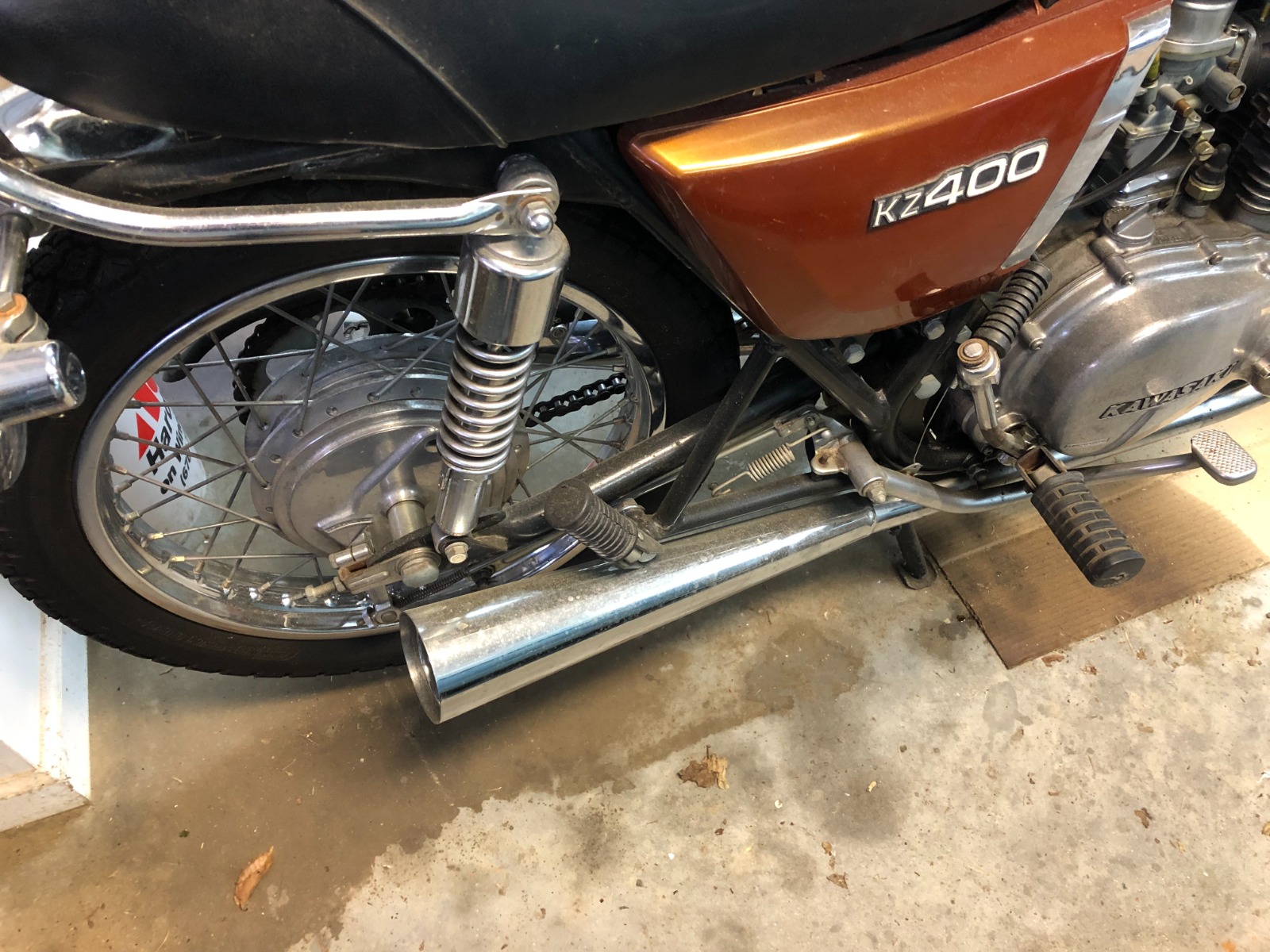

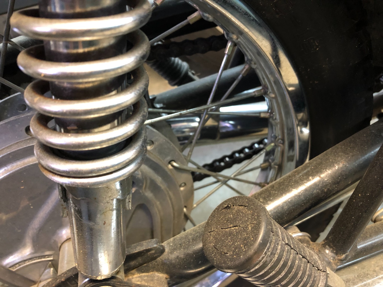

Mine's a '76 D3. Where I live there are no inspections. Hard to imagine having to put up with that...
Anyway, they are holding up fine but then it is garaged and seldom ridden. I'm dealing with a front brake conversion so until that is done...
Checked my notes and I bought these from Lowbrow Customs in '12 for $114. In the pics you can see how they mount. They are not the universal types that use adjustable hangers.
