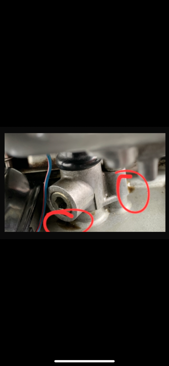

Oil leaks
- kh250kz1000
- Posts: 1
Oil leaks
04 Nov 2021 09:22 - 04 Nov 2021 11:45
Last edit: 04 Nov 2021 11:45 by KZQ.

Re: Oil leaks
04 Nov 2021 13:53
Clean the engine and get the athlete's foot powder in a spray. Cover the engine with the spray. And you will be able to see where it is coming from once the leak starts.
This is a tip from Mike Nixon at Motorcycle Project. I just can't find the link for it.

Re: Oil leaks
04 Nov 2021 15:10
Yes, any talc type powder will do, been doing this for years, Johnson's baby powder was the one I used, not sure if they make it any more..
