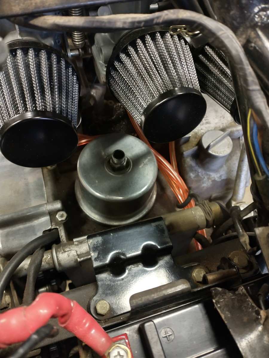

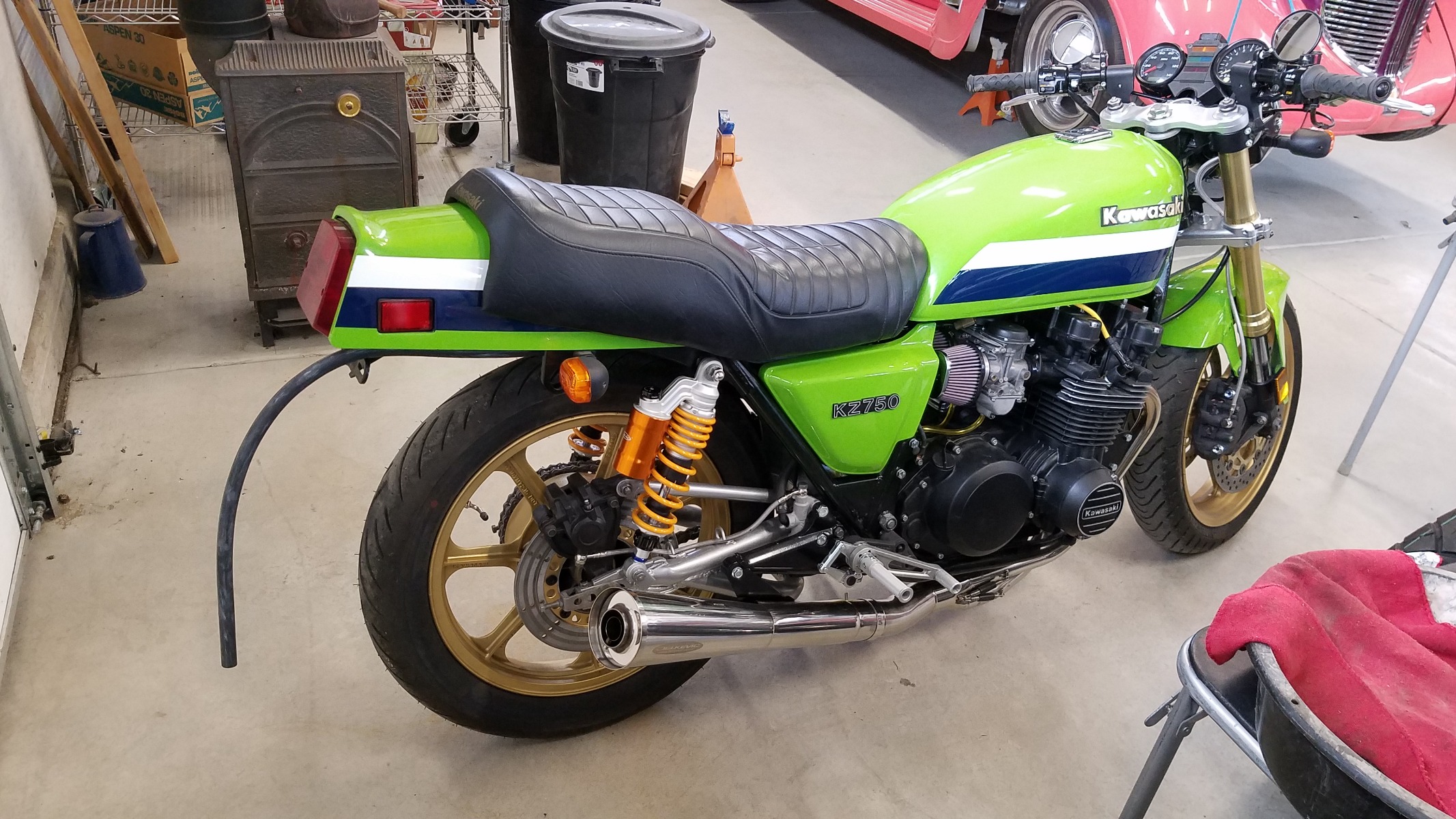

For the vent,
1. Connect a long piece of hose that goes up and over the frame and out the back of the bike.
2. Run a length of hose from it to a catch can. This is more expensive than 1 and not really necessary unless you are racing.
3. Use a really short bit of hose and a K&N crankcase filter. This is a more expensive option and may leave a fine mist of oil on the engine.
4. Devise a system that pulls a light vacuum on the crankcase. Expensive and maybe complicated, it you may gain 0.01 horsepower and it may attract sexy women.

13 Oct 2021 09:33Thanks! I think Ill go with #3, I believe I may have a small filter pod laying around here somewhere....For the vent,

- Posts: 3161
- Thanks: 1252
Re: wet valve cover gasket after replacement
13 Oct 2021 19:25
