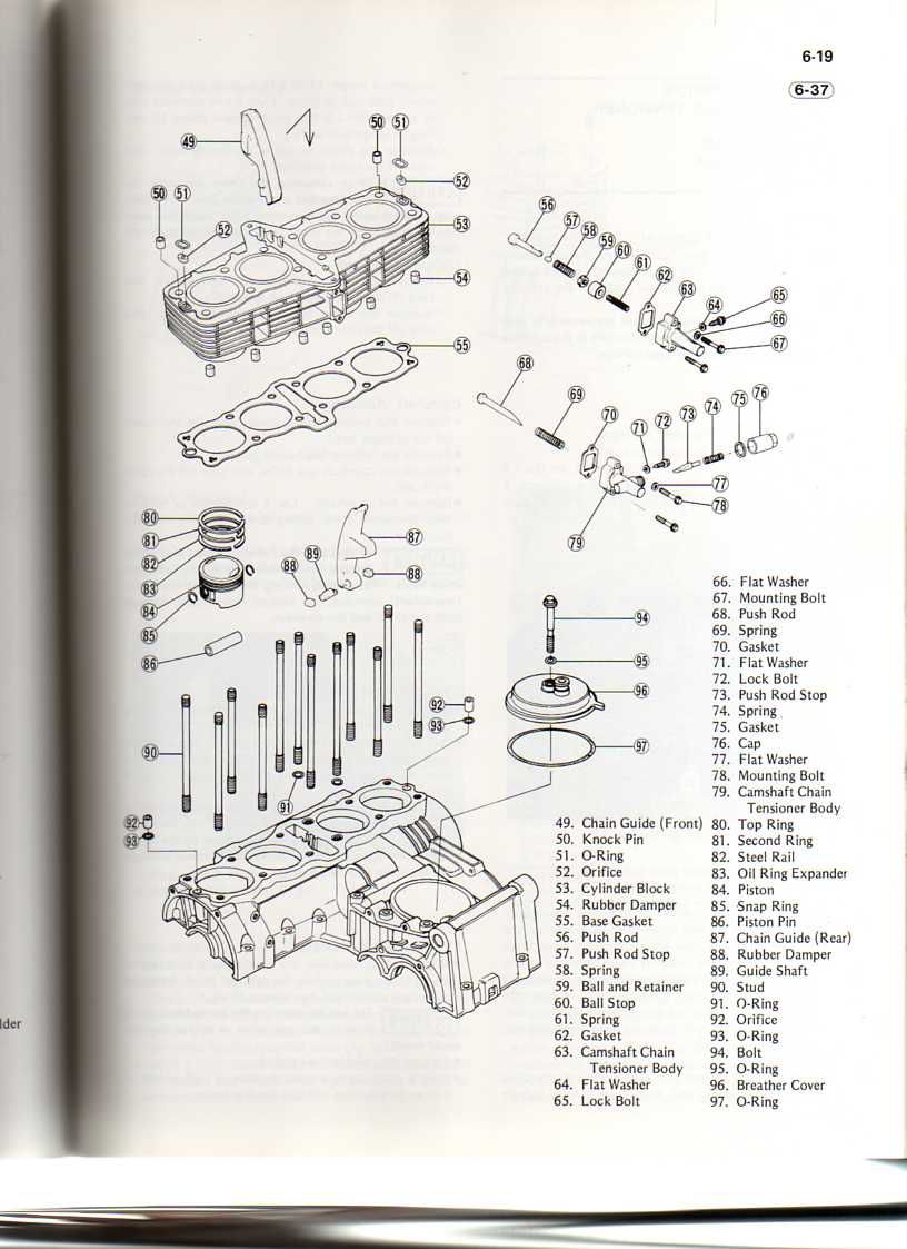

Not sure either of these docs will be of help or not, but wanted to pass them on in hopes they are of help.
1977 KZ650 B1
Pods and Denco header
OLD KAW OWNERS SMILE ALOT
