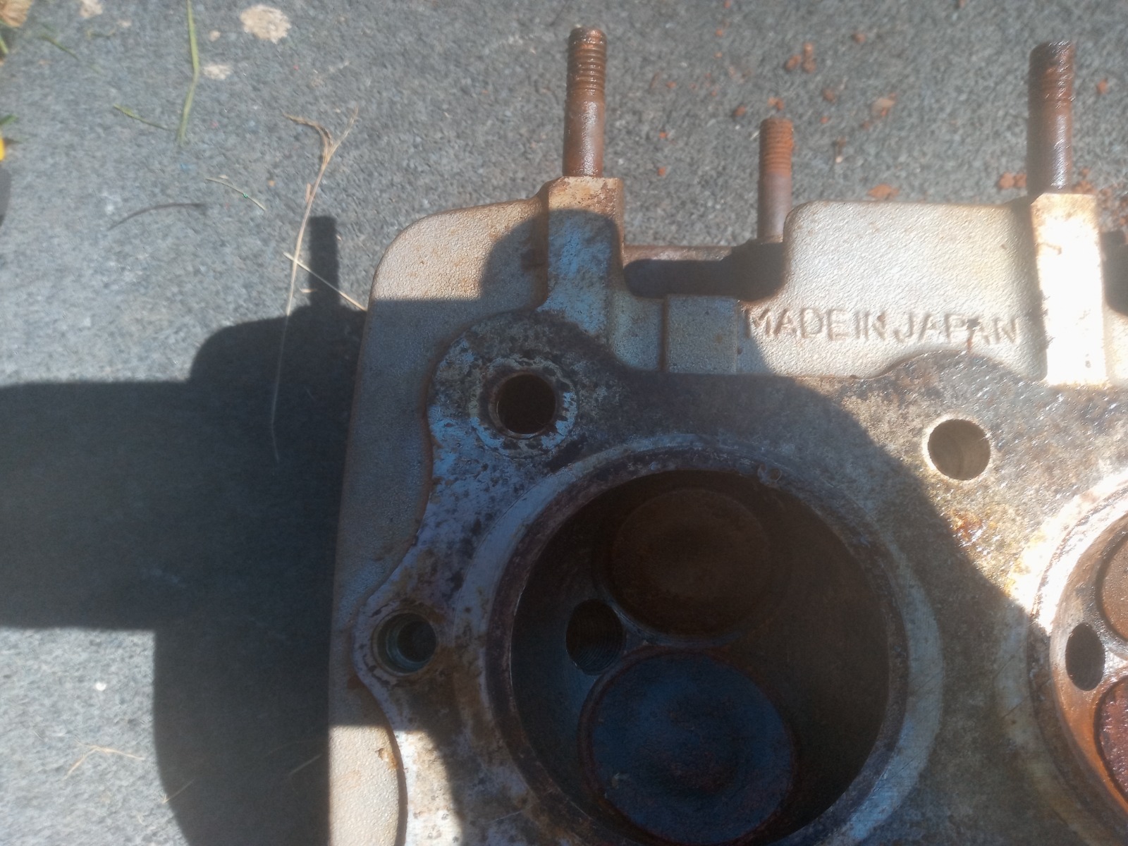

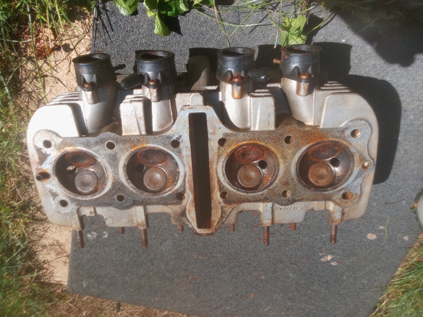

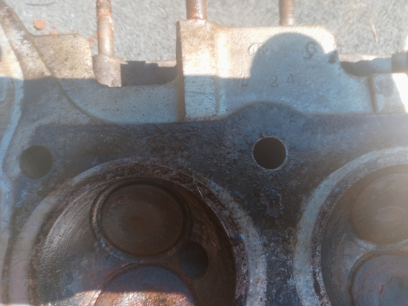

Looking to identify this cylinder head that came in a parts lot I just purchased.The bulk of parts are for 1980 ltd1000 but another crate had this head along with the cams .There is markings Z 24 and a big G as seen in pics. I know someone out there knows.

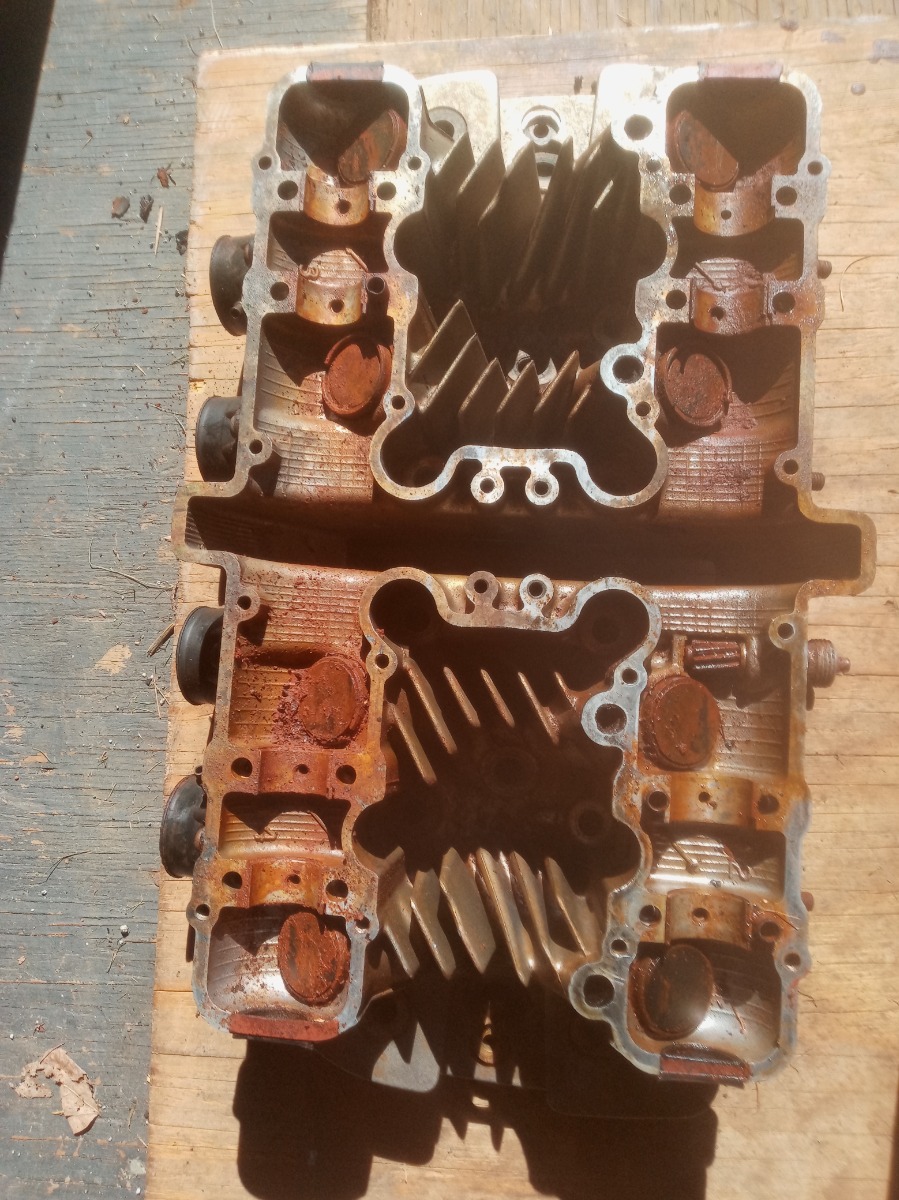

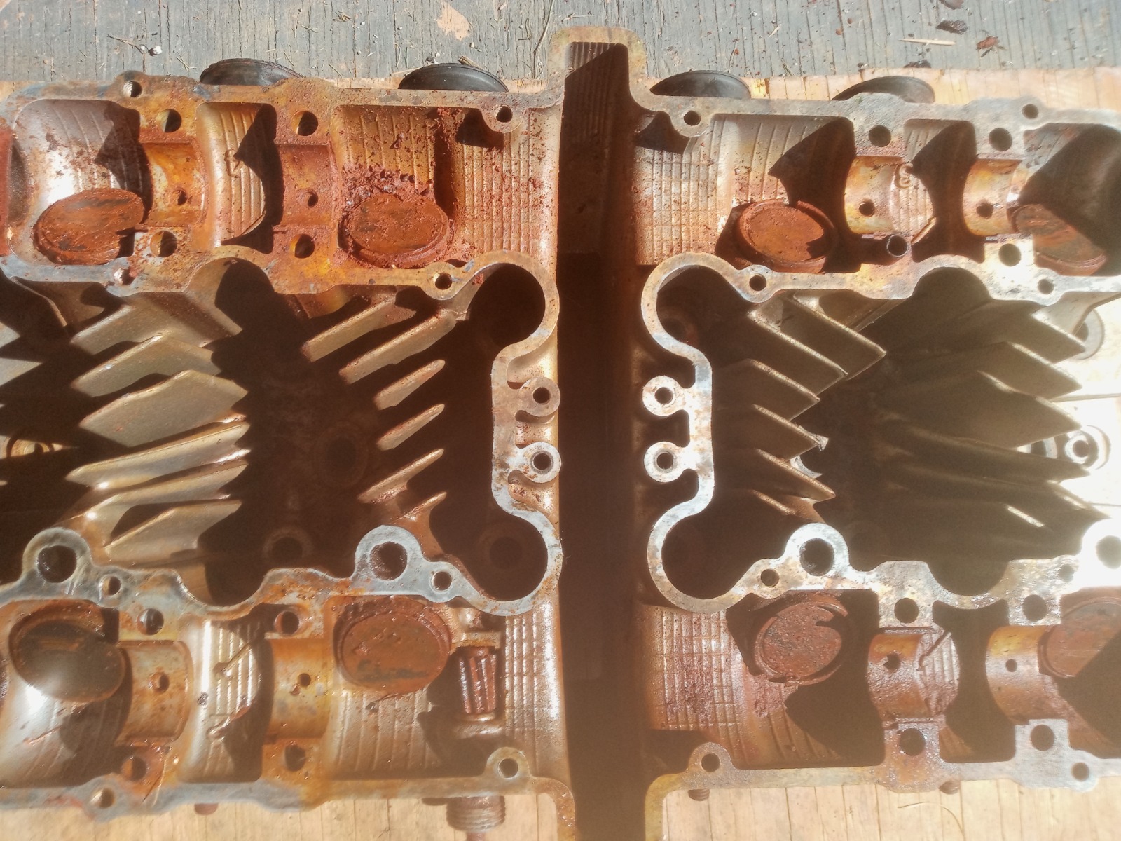

How about a picture of the cam side?

8mm exhaust studs so a 1000 head ( although all 900/1000 heads are interchangable).

The air injection ports say it's a 79/80 MK2 head. Any chance your have the matching cam caps? Otherwise it may be just a door stop.
