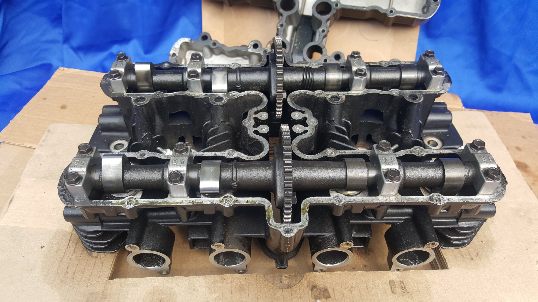

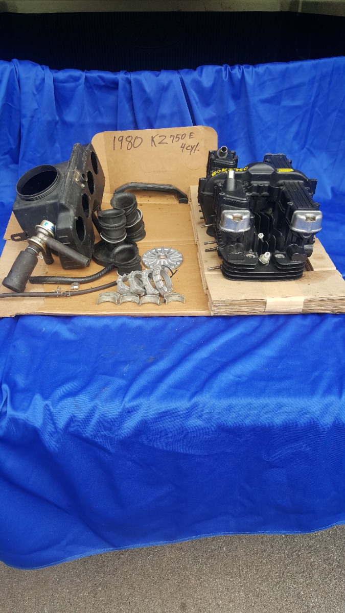

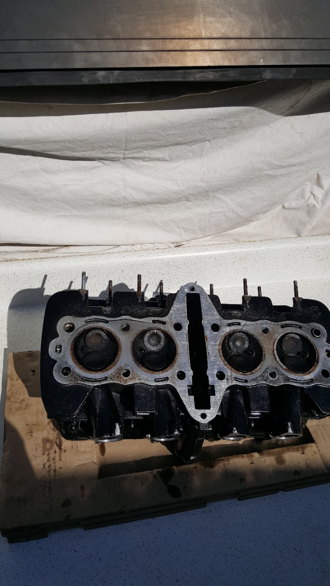

hi bud would like them but im in the uk shipping would be too much but thanks for the offer.
