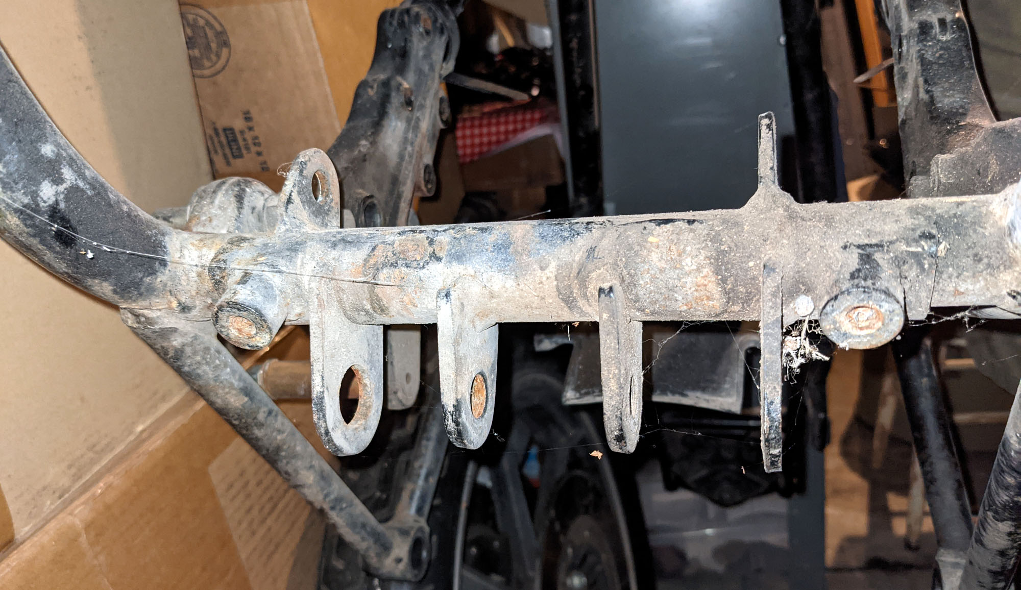

06 Sep 2021 19:53 - 06 Sep 2021 19:55The Z1R and the KZ1000A have the same engine internals, but different carbs. The Z1R has 28mm, and the 1000A has 26mm.
One issue I see with the Z1R exhaust on a KZ1000A is that the Z1R exhaust has mounting tabs on the back of the collector box. You can see them in the picture above. The Z1R frame has threaded bosses on the same bottom cross bar where the center stand mounts. The KZ1000A frame does not have these bosses, as far as I am aware. I don't see anything similar in the part drawings. I'm assuming the Z1R exhaust joints would be stressed if it were to hang free under the engine.

@DOHC: I did wonder about fitting the collector box, thanks for the picture of the frame. It looks like it will be easier to stick with the stock system (especially given that I hae a set of stock carbs).
Niether of the systems could be classified as cheap
