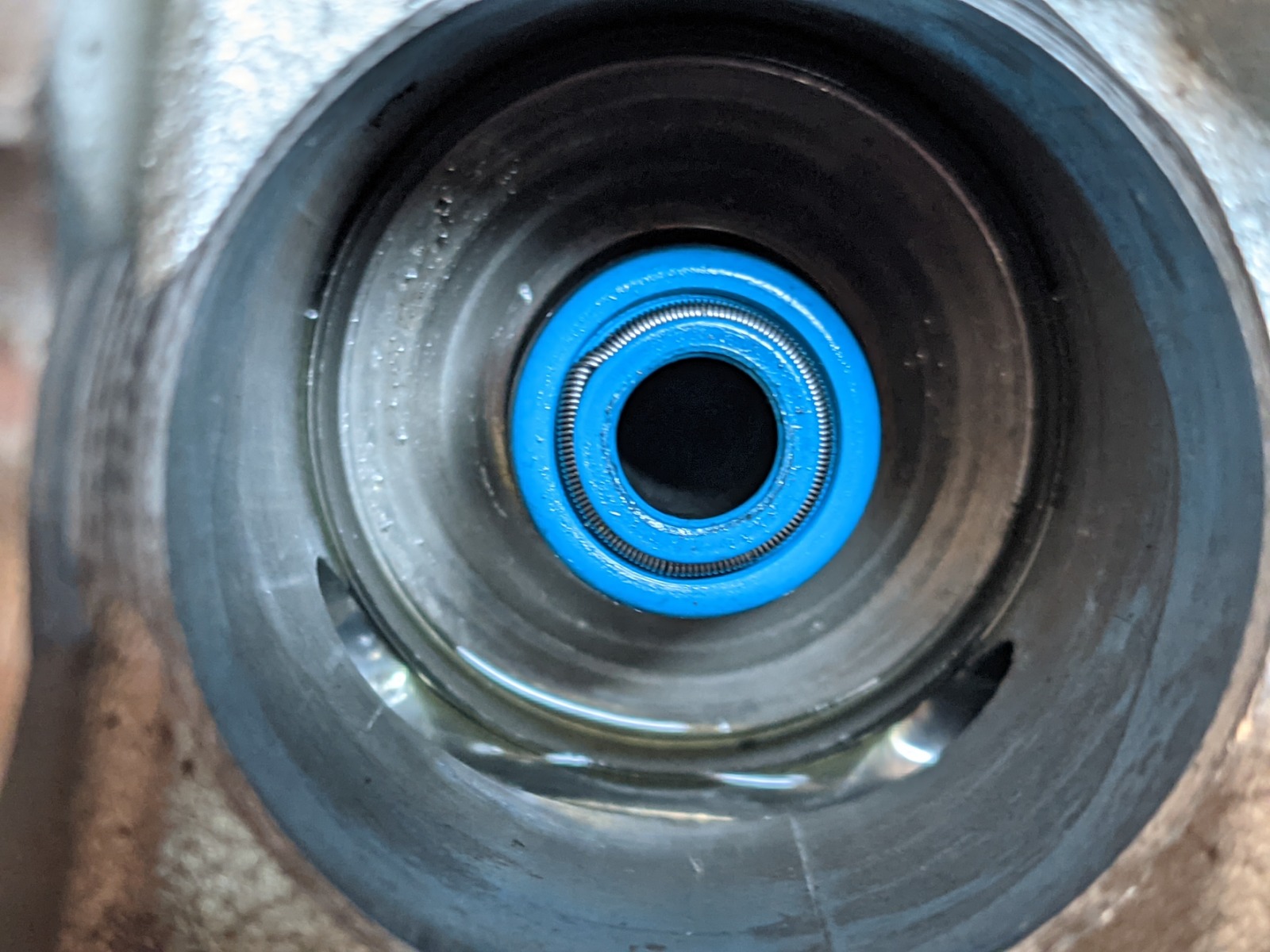

Hello all,
I bent a couple valve seal springs that wrap around the top opening when putting new ones in.
Question: Is this the end of them? Should I replace or will they be okay.
Really don't want to have to reorder and redo but if I have to then it is what it is.
Thanks,
Jakob
Thanks,
Jakob

They definitely will not function as "new" valve guide seals in that condition. I personally would bite the bullet, reorder and chalk it up to a learning experience. They say experience is a very good, but sometimes expensive teacher! At least you will then have peace of mind.

Thanks Mike,
I agree, these are relatively cheap compared to other parts that could get broken. Your input is greatly appreciated. Gonna re-order, replace, get some peace of mind, then keep on learning.
Thanks,
Jakob
