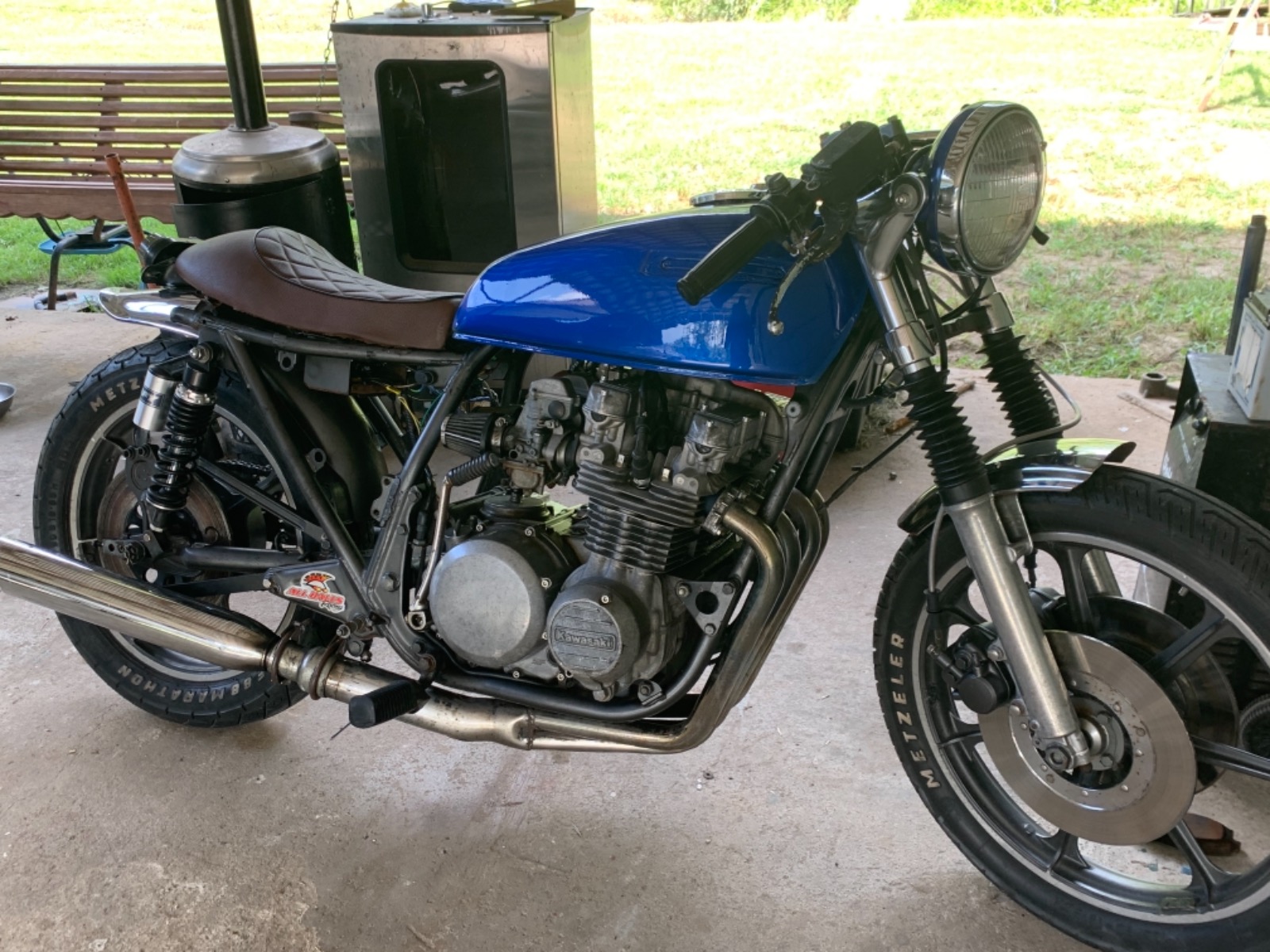

Hello fellas. I’ve got a question about swapping transmissions between a 1977 kz650b and a “82 kz750h. I’m wanting the bigger 750 engine w/ the kickstart transmission of the 650. The question would be, is it possible? And thanks in advance for any feedback. I would like to post pics of the cafe racer I made out of the 650 but I can’t seem to figure it out

I think I got the picture thing finally
