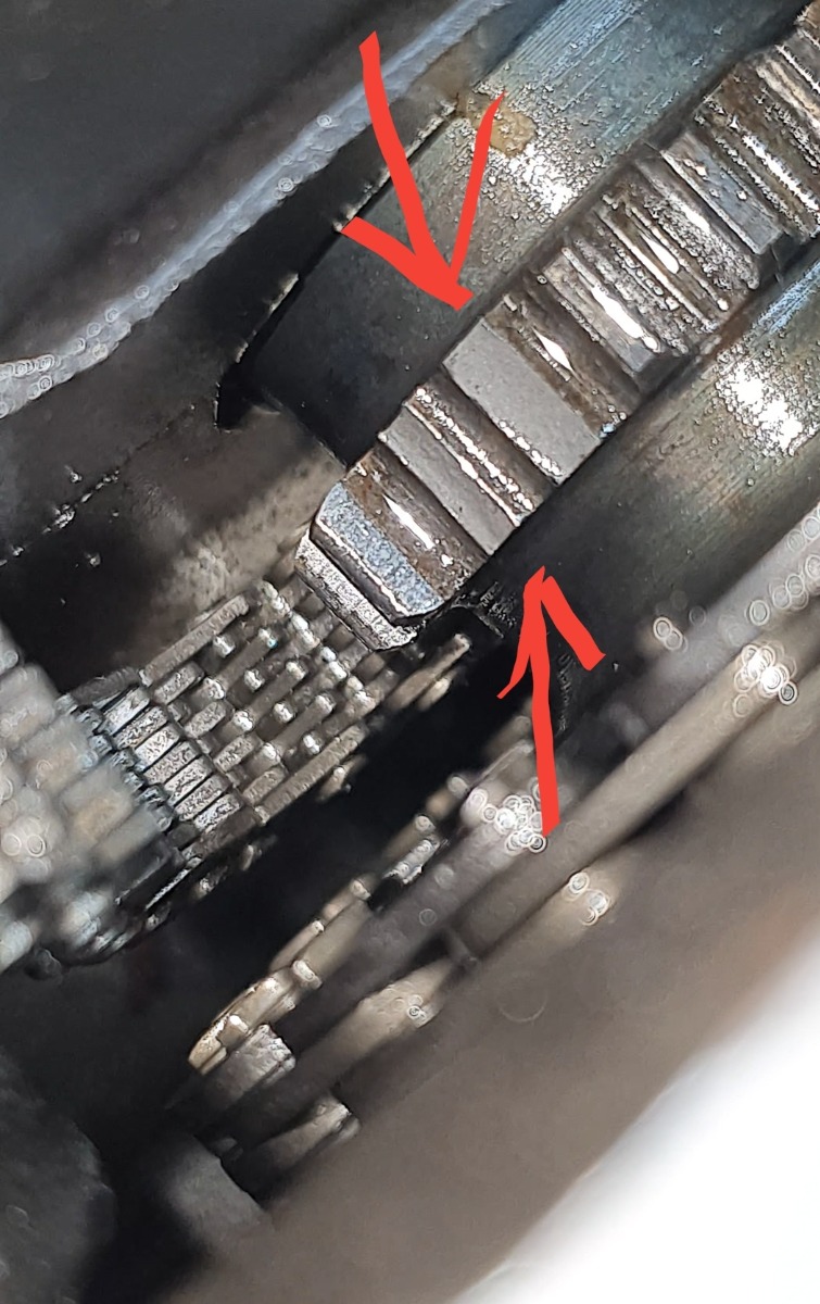

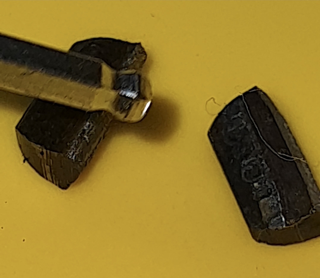

friends i have trouble! bought an engine but it is defective. broken two teeth on the crankshaft. a question, tell me, the crankshaft from KZ 750 is suitable for the KZ550 engine (ZX550-GPZ550)

Nope.
GPZ 550 bore/stroke = 58 x 52,4 mm
GPZ 750 bore/stroke = 66 x 54 mm
KZ 650 bore/stroke = 52 x 54 mm

Thank you, the patient is just convinced. then another question will come from zephur (zr550) ???

I am just wondering out loud (in electronic print) if the 750 crank and rods could be used with 550 block, pistons and head, for a 58 X 54mm combo?

650's and 750 share a lot of engine parts, but not with the 550. The smaller engine is quite different.

07 Aug 2021 07:01Looks like the same part number for Zephyr and GPz.Thank you, the patient is just convinced. then another question will come from zephur (zr550) ???
www.partzilla.com/product/kawasaki/13031...ae66e4cfe67886ff8b95

Cylinder spacing is closer on the 550 than 750/650. That should make for a challenging fitment project.

Thank you very much! I will search from him, it is easier to find him. after I write about the results (instagram #wiats)

or you could just have the gear repaired

I thought about it too. but where can I find such a good uncle in the video))) I'm considering this option if I don't find a crankshaft
