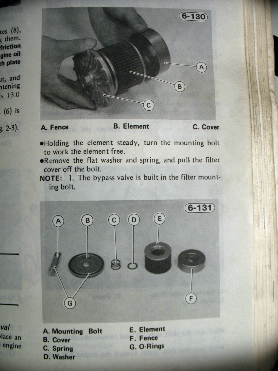

According to the KZ1100 Shaft FSM that cover is a fence.
