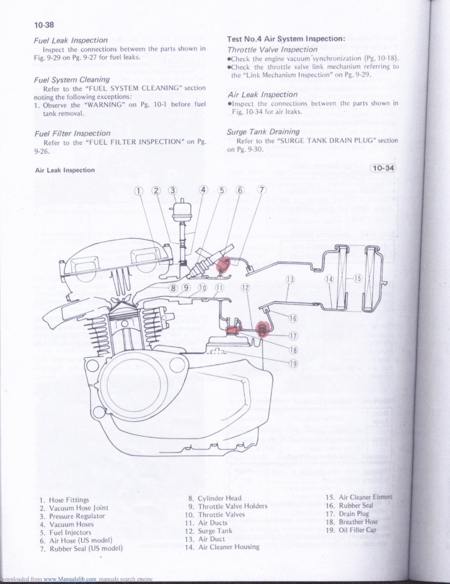

Take a look at this DFI document. There are many potential leak points and all of these have to be checked out.
There are holes in the airbox for a grommet (at the top), a rubber drain plug at the bottom, airbox to breather
cover hose, and vacuum hoses, etc. Make sure the airbox is sealed (no open holes drawing extra air in).
