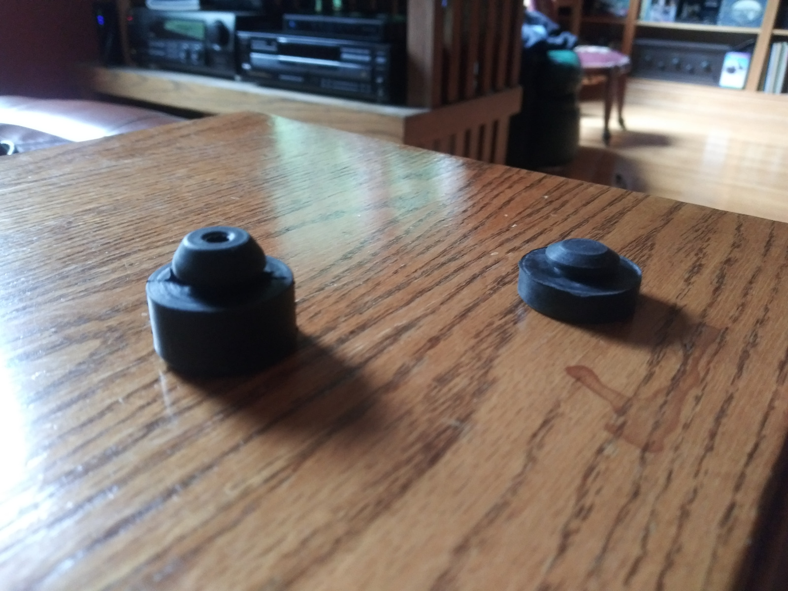

Does anyone know which of these is for the side stand and which is for the center stand?  They're really hard to get in and even harder to get out if you get it wrong so I want to make sure.

The rubber stop on the left is for the center stand and the right rubber stop is for the side stand
Left = centerstand
Right = side stand
Make two parallel cuts, push first side in hole, push 2nd side in with screw driver.

I saturate the center stand damper w LW silicone spray.
Left = centerstand
Right = side stand
That was my next question.  But make 2 parallel cuts?  So basically you're cutting it in 3rds then?
Left = centerstand
Right = side stand
This worked like a charm, thanks.  The side stand rubber, I made 2 cuts perpendicular to each other then screwed it in as much as I could and stuffed the last quarter in with a flat head screwdriver.
