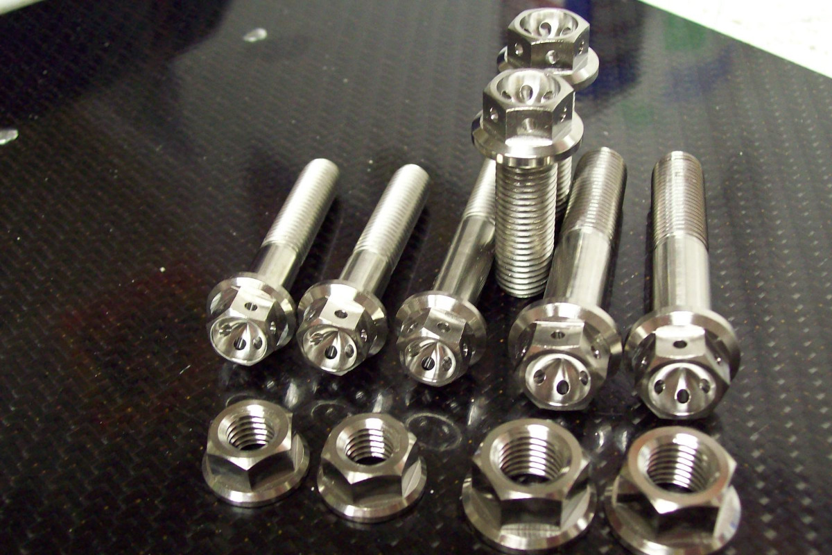

Dr. Gamma, where do you get your titanium fasteners?  :)

Hey DOHC the last few times I got some titanium fasteners they came from Titan-X in England. They have a few different styles of fasteners in most common sizes, and they all come drilled for safety wire. Just wish their nuts came drilled for wire. Their prices are reasonable and they ship quick from the other side of the pond!!!! There are all kinds of places now selling titanium hardware and they all are reasonable priced compared to what I used to pay for titanium fasteners 15, 20 years ago!!!!
www.titan-x.co.uk

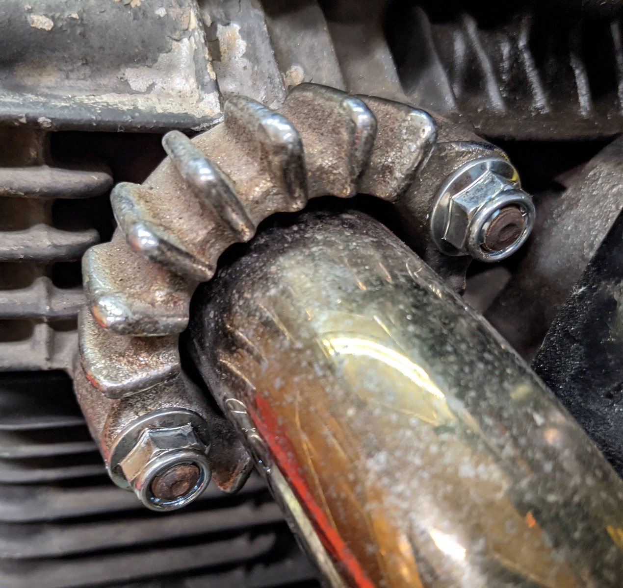

I thought I'd add an update.  I ordered some fuji style nuts from a place called MotoSport.
www.motosport.com/bolt-fuji-style-metric-lock-nuts?variant [BMH000S]=BMH000S-X001-Y003
They seem fine, and were not ridiculously expensive.  However, it turns out the stud is not quite long enough to fully engage the lock tabs.  It's close....
