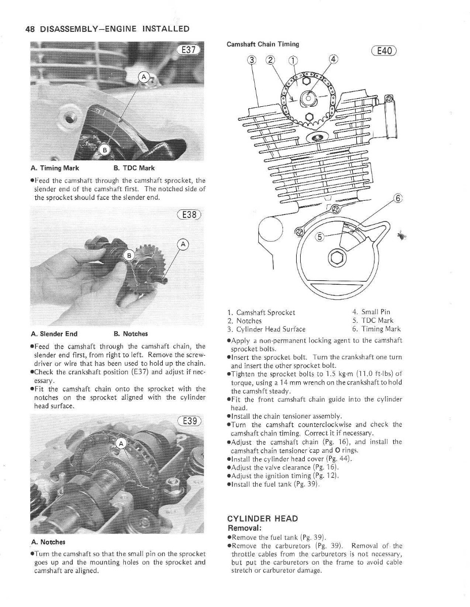

Hello
I have a early 80s kz305 what I’m having trouble finding how to set the cam shaft timing on
I had to take the head off to the bolts removed but with the head back in my shop I can’t find any marks on the cam shaft as to where to set the timing for them
I have the copy of the original manual and the repair manual and have spent several hours on google and even went to a local shop
all with no progress
Any suggestions are definitely appreciated

The repair manual give you the answer to setup the cam timing right.
kzrider.com/modules/ServiceManuals/Kawas...0KZ250%20-%20305.pdf

Under the left side cover, look into the window and match the "T" mark (next to the F mark) with the arrow on the case. Then put the cam in with the line marks on the sprocket parallel to the head/valve cover mating surface. I like to do a couple full rotations after getting the chain on to make sure I have it right.

Excellent thank you guys for your help
perhaps I had the wrong repair manual
