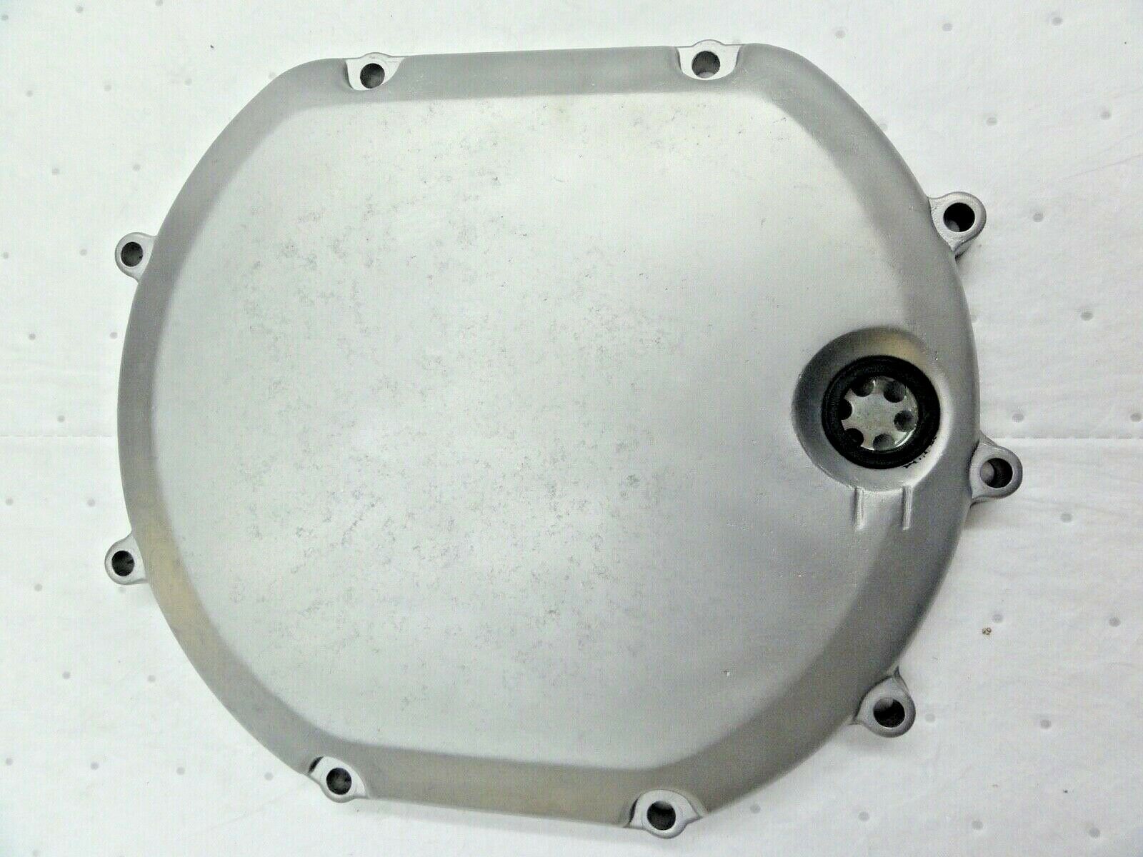

What's the difference between KZ1000 and Z1 clutch covers?
07 Jun 2021 05:30 - 07 Jun 2021 05:37
Seller says it's different than Z1 and KZ900 covers but will still fit. It looks exactly the same to me.

Re: What's the difference between KZ1000 and Z1 clutch covers?
07 Jun 2021 06:07
The engine covers got thicker either between the Z1/KZ or the KZ900/KZ1000. Probably to lessen mechanical noise from within, they will interchange.
07 Jun 2021 06:48
900 and 1000 covers are visually the same and interchange.
As mentioned above, the later covers are thicker for sound deadening.
Only the later MK2 covers are visually different having a raised centre but again they bolt straight on too.
07 Jun 2021 10:11
No additional comments other than I’d say look inside and see if there might still be remnants of an ink type stamp for a date. I’d keep as many dated items as possible. I’m sure either glass bead or vapor hone would remove the paint and restore the exterior finish.

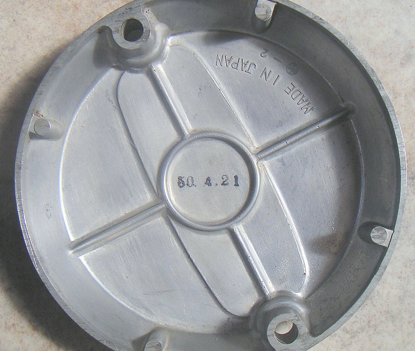

07 Jun 2021 10:13
The following user(s) said Thank You: Robb2018
07 Jun 2021 10:20
To be correct the stamp would need to be
47 xx xx. The second xx will be the month and then xx will be day
example, 47 09 10 would be September 10 1972

I thought I saw them as painted. Sorry. The best way to have the chrome is chemically stripped. Basically a reverse of the chrome process. Tripp Plating in Buffalo NY.
Here’s where I pass it off the experts. I’ve seen some Z1 engines with chrome covers. I have a ‘74 engine that they are all chrome. I haven’t found anything in John Brookes book about any covers factory chrome. This is a good time to find that answer.
Edit: If your clutch cover is original to the bike it will have S-1 cast on the inside of the cover. Also will have the ink date stamp
