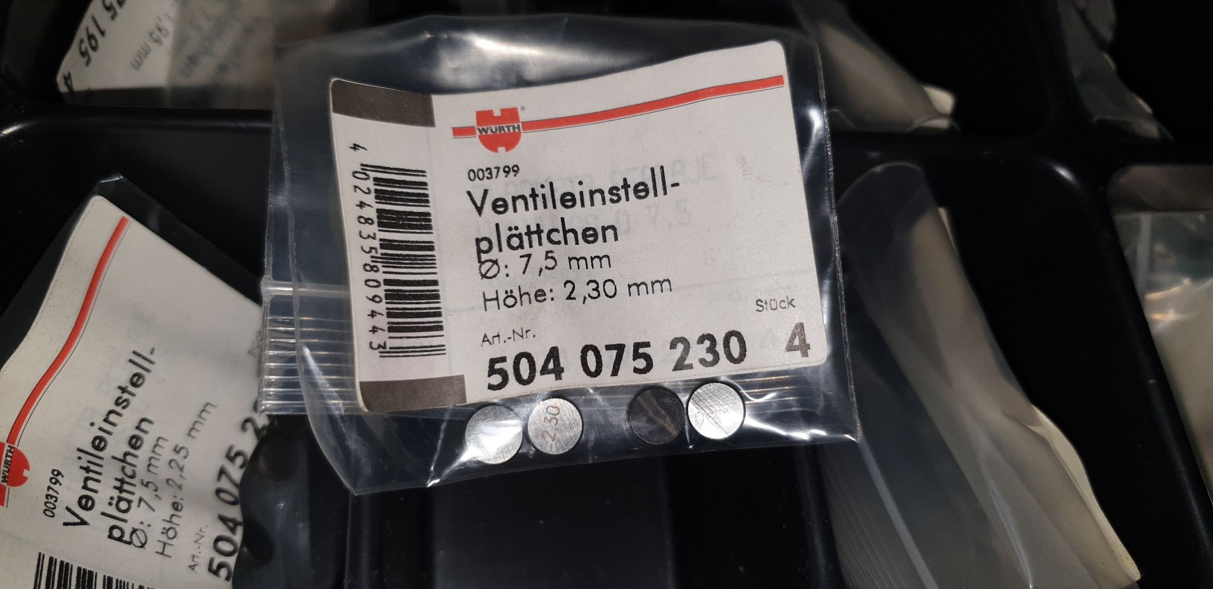

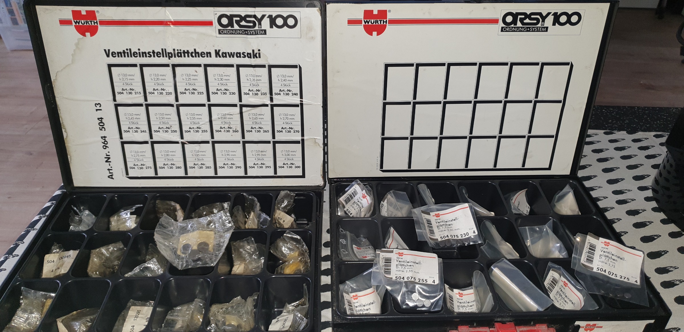

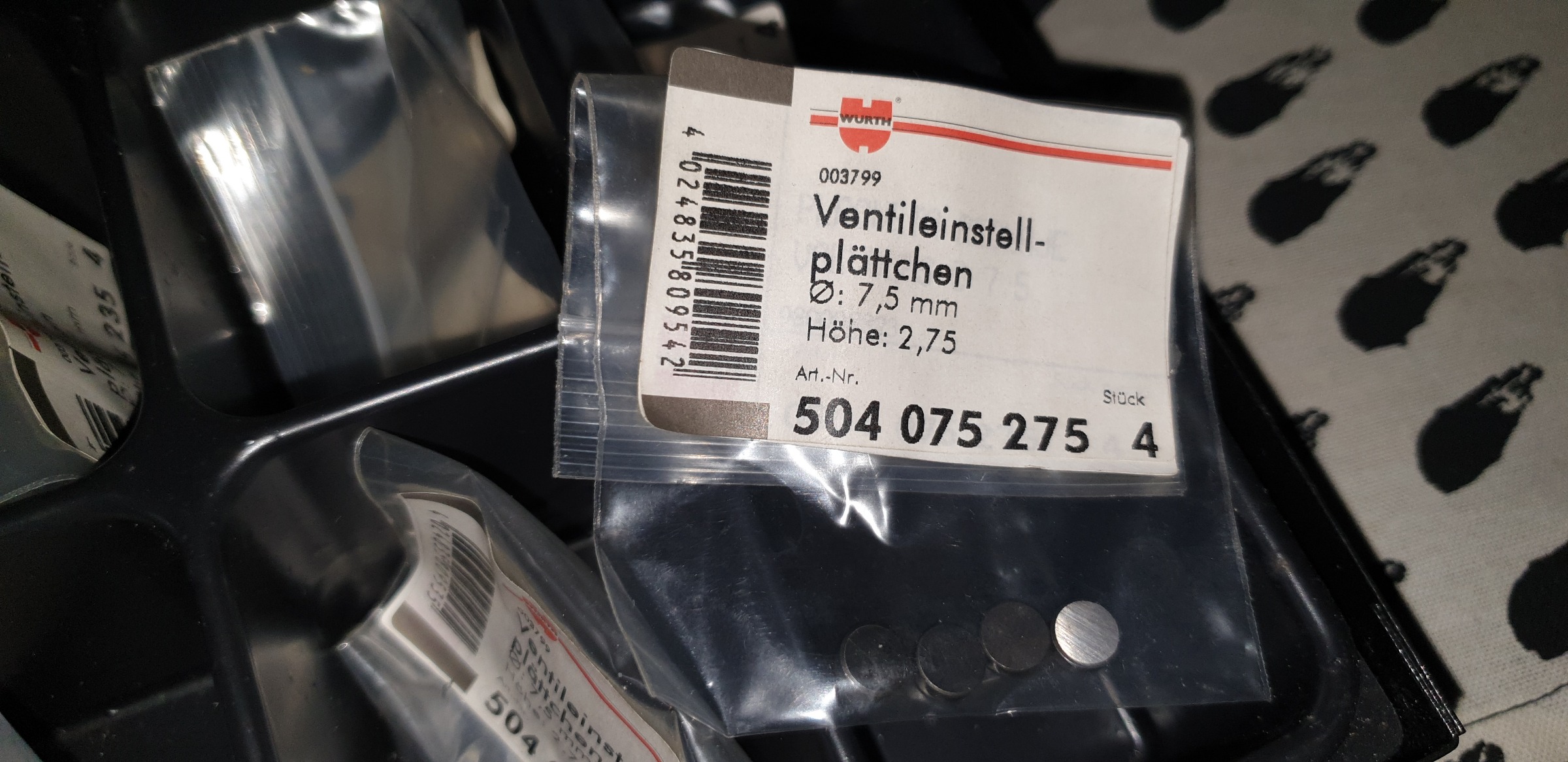

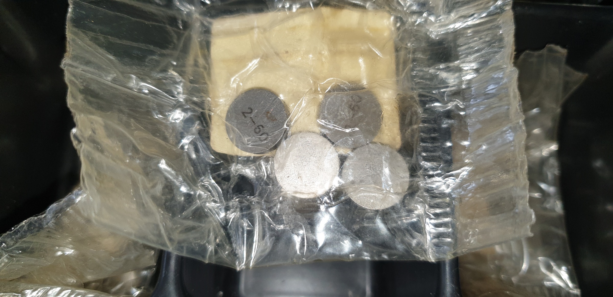

Shim kits do have regulary 4 shims of each size but you can buy or share shims you need at your local bike shop.
Here are my Würth 13 mm and 7,5 mm shim kits.
