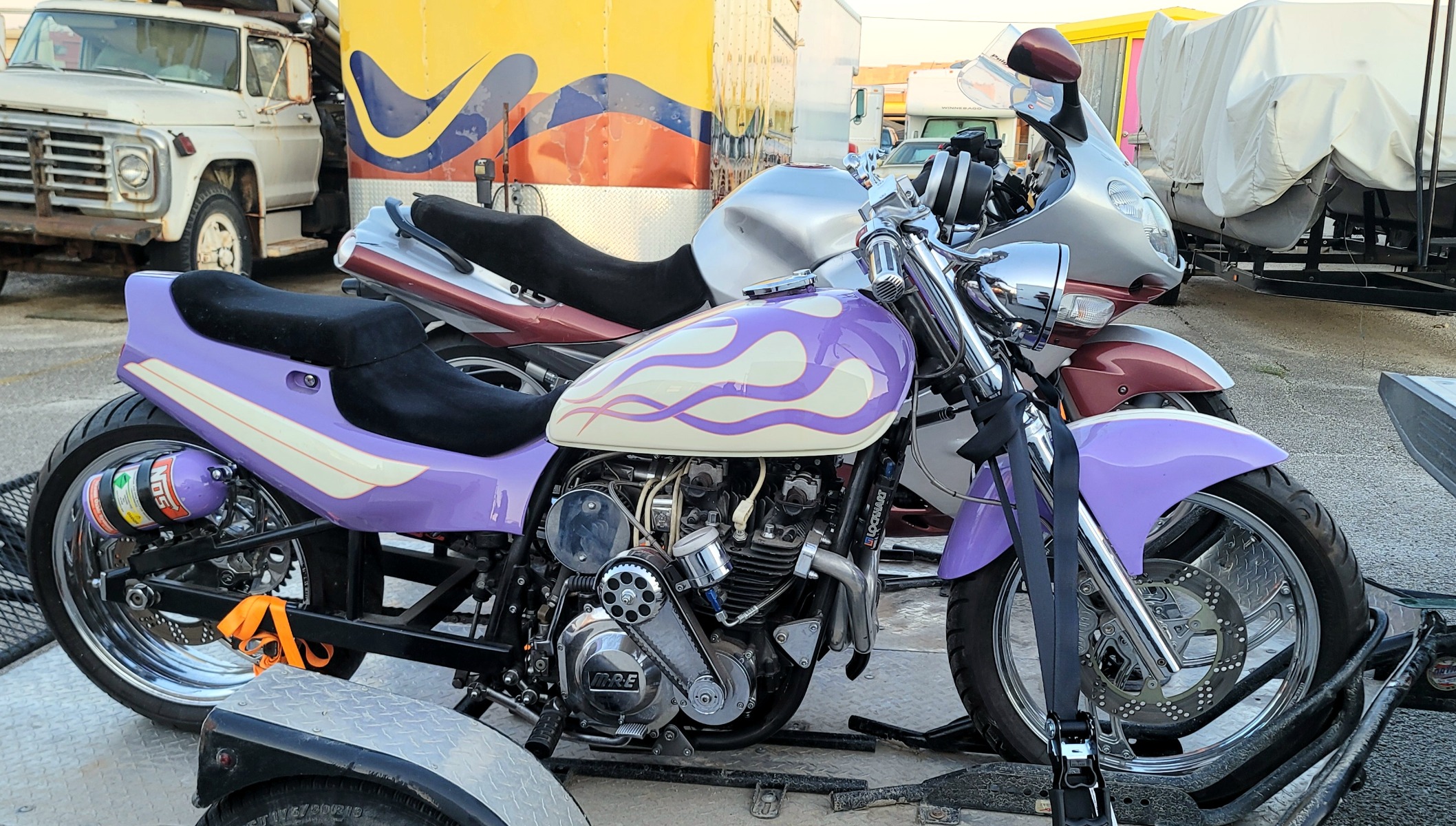

Nice Bike .
The bike appears to be a real hot rod. . More of a Pro Street bike / Drag Bike.
You have a unique problem.
What work are you in need of ?
Most of the bike is no longer stock. Turbo/ Race distributor/. Nitrous / Hydraulic clutch / rigid rear end are obvious updates.
Bike is what a true hotrodder would love to tinker with , but Most of us with similar bikes are not near you .
I could do it but am in Michigan, Les Holt in indiana, and a few others
Post questions and we will all help

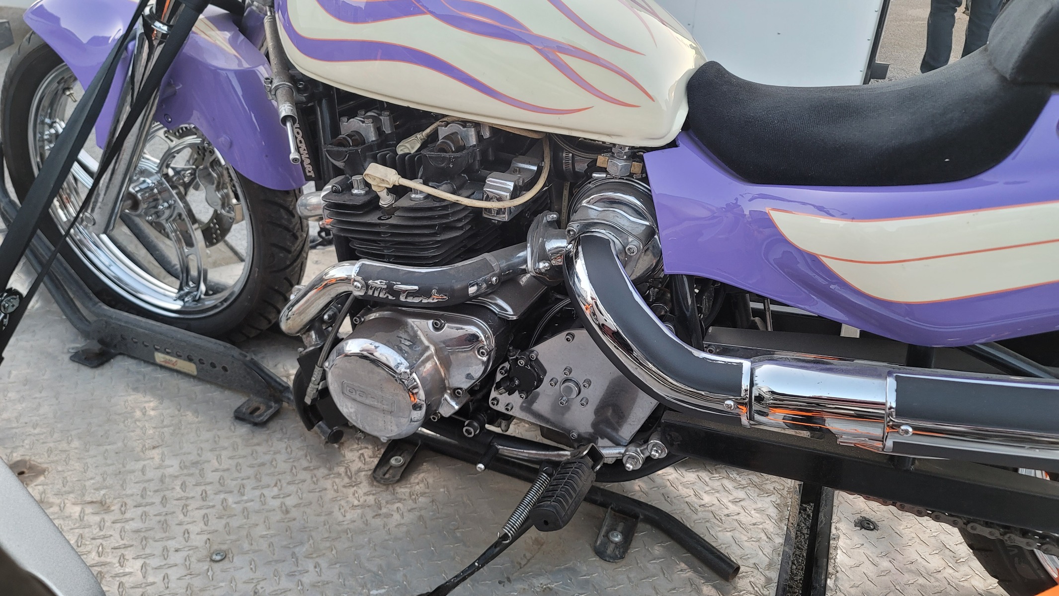

Thanks for the reply, Dave. I bought this bike from the son of the deceased owner. He was unable to provide any details, so I bought it at face value. The valve cover was missing, I've since bought one, and I'm unsure why it was removed....I was told that the owner built this himself along with a few others; was a wrencher. So, I don't know if something went wrong, or if he just added the cams, or what the situation was. What I did find was a broken thread which can be seen in the picture below. The broken piece is down in the timing chain area.

The head needs to come off to fix that. or swap another head into its place
You may be aware that the cam tower is missing from this position .
90 percent of what needs to be done can be fixed by anyone with knowledge of stock kawasaks.
The 10 percent is knowing what cams ,/ piston combination you have to insure proper tolerances and adjustments ( Not rocket science )
Dont turn over motor unless specs are checked first, as I dont understand from picture why cam chain is tight without tower being installed ( Dont want to bend valves or anythink else )
Ask any questions you have and they will be answered

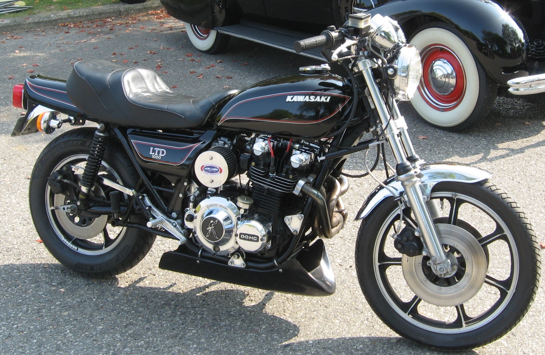

PS Here is my turbo

PS Here is my turbo

Wow! Pretty wild with some quality parts! Want to hear my simple common sense plan?
Pull all of that stuff and engine out! Sell all the high performance stuff out. It looks like this person did not skimp on money building it.
Sell off the complete turbo package. Sell the ignition. Sell the lock up clutch. Sell the nitrous kit! The inside of engine is most likely beefed up with welded crank and all the best components? Welded clutch basket? Back cut tranny? Excellent eBay potential! OINK the ebay cult leader would make $ thousands of dollars!!! Those parts are worth some good money!
THEN, put a nice stock engine with carbs and make a nice 4 into 2 header system for looks, same on both sides of bike.
At least, that's what I would do.
Then you still will be the coolest Old Kaw at cruise nights! Everybody checking it out!
