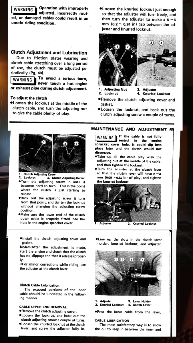

Re: 1977 KZ650c, When gunning throttle, engine will rev up but won't increase speed.
07 May 2021 04:40
This is for a 78 650 via the owner's manual.
Check your owner's manual for the correct procedure for your specific model.
Manual excerpt via file base.. OKC_Kent

- Posts: 8403
20 May 2021 08:00 - 20 May 2021 08:01
Be sure to follow the procedure exactly, as the order of adjustment matters.
If adjustment does not solve the problem, you will need to inspect the clutch. You will need a new cover gasket.
The most common problem is worn out springs. They are fairly inexpensive and easy to replace. The factory service manual lists specifications for clutch plate and tab to basket wear. Inspect everything carefully and ask many questions.
