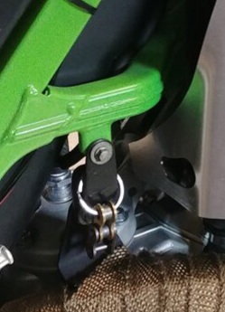

Had the fun time of a chain coming apart on the freeway at 50mph.
It hit me in the back, but with a back protector I didn't really feel anything.
It did take a chunk out of the aluminum rim.
While putting on the new chain I found the link without a clip.
I realized I may have dislodged the clip when cleaning the chain with a chain brush.

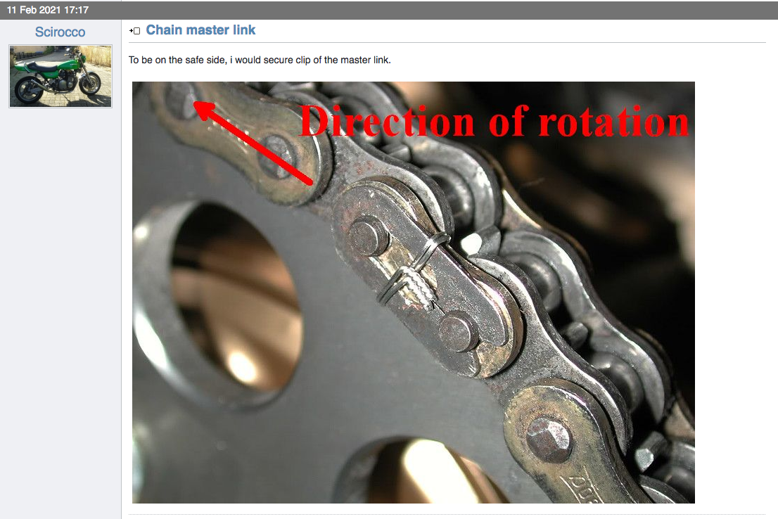

Not fun..Use a riveted chain or safety wire the clip like Scirocco.

I lost a clip years ago. Noticed it was gone when doing a routine inspection. The plate was still in place and unlike the really old style they are pretty much pressed into place. I think the clips can break. Springy so perhaps brittle ? Since then I put a wire on the clip. It's easy to see when doing a quick check.
