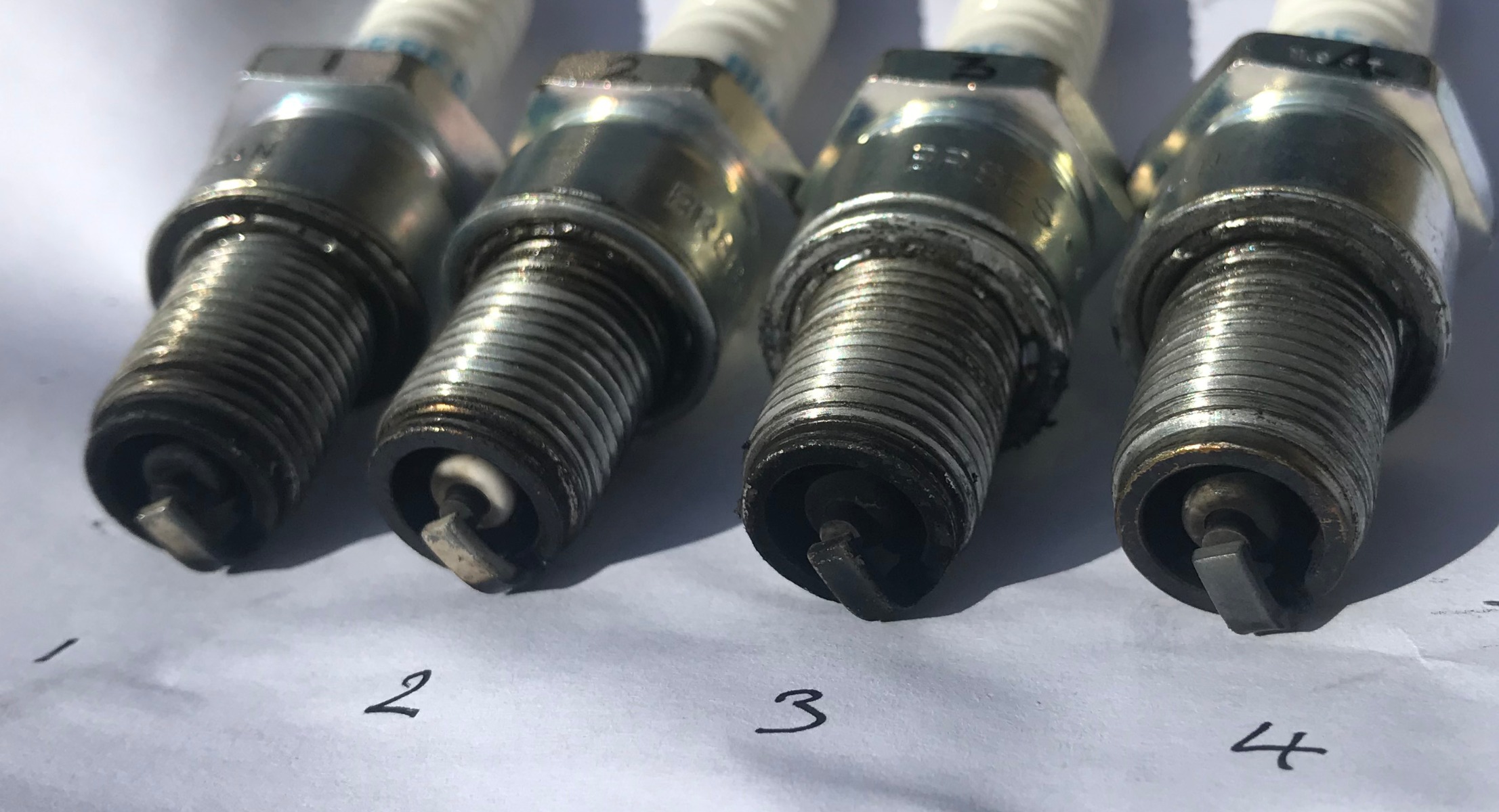

Attached is a pic of the plugs. They don't look a consistent colour so it's not happy about something.

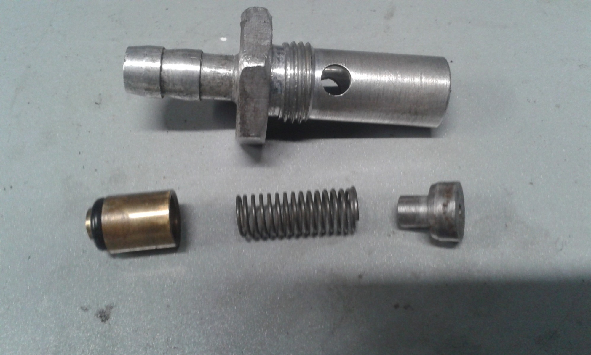

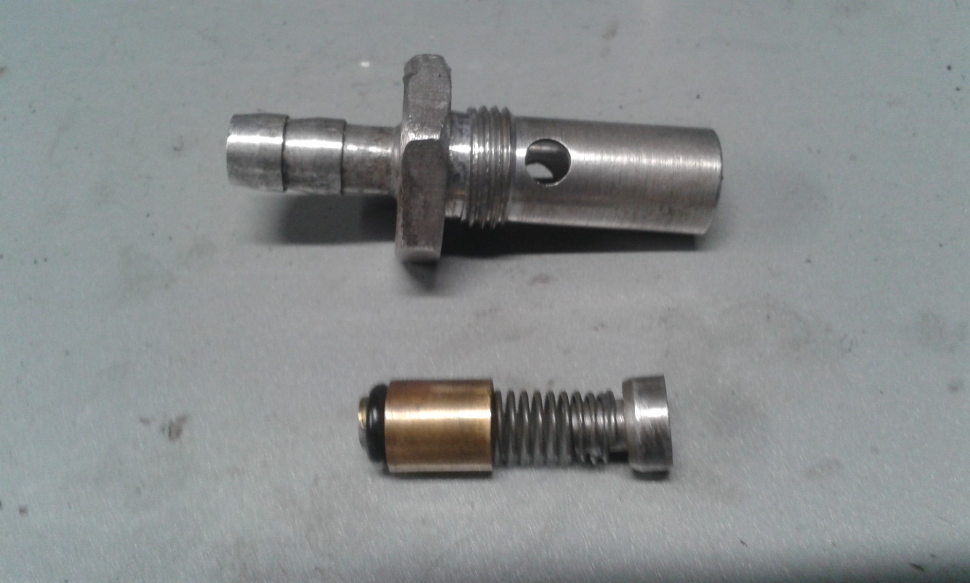

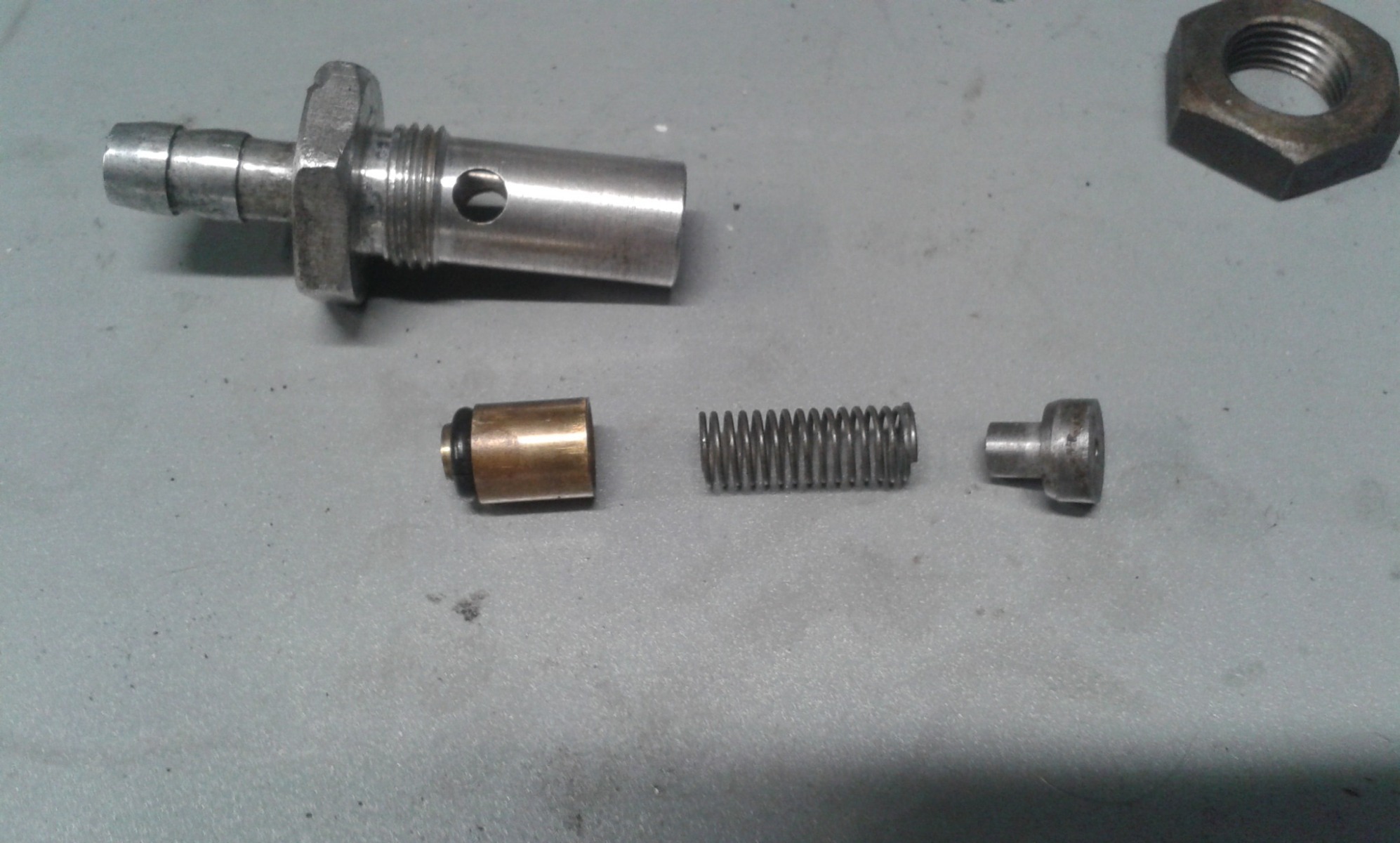

Re: GPz1100A2 afterfire
24 Apr 2021 01:43
Looks like your check valve mechanism is clogged by rust and need a good clean. Fuel pressure will get to high, bike is runnig on fat air/fuel ratio. Its a common problem on the EFI bikes.
kzrider.com/forum/2-engine/615786-fuel-t...asket-sealant#847300

Thanks Scirocco. replaced that last month with a brand new one as the old one was rusted, so I don't think it will be that.
I too am leaning towards something mixture related but not sure.

It's too rich, especially #3 and #4. That can cause a backfire. Did you install the tank check valve before or after
replacing the spark plugs? New spark plugs are needed.

One thing i did notice yesterday when I ran it again was plugs 3 and 4 were significantly hotter than 1 and 2 when I pulled them out. i.e I couldn't touch them, but 1 and 2 were not quite as hot.

Your plugs should be too hot to hold after the bike has run.
The insulator nose hovers between
500°C (932°F) to 800°C (1472°F).
I'd be curious why 1 and 2 are not hot.

Yes, me too. If it was coil related you'd think it would be 1 and 4 or 2 and 3.
I'm thinking its something to do with fuel delivery. I'm going to pick up an infra red gun tomorrow and see what temps the exhausts are running once it warms up.

Hard to know. I've given up on guessing because a lot of times I have been wrong.
But those cylinders seem a bit cold.

The backfire is occurring in cylinders #3 & #4. Excess fuel is being burned in the exhaust pipes of #3 & #4.
The heat transfers to cylinders #3 & #4. So, those spark plugs got hotter.
