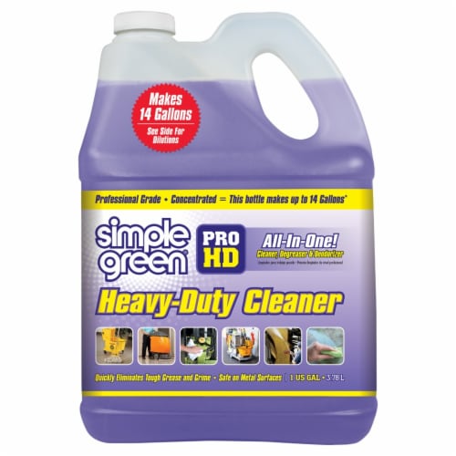

02 Jun 2021 16:51I'd kind of like to spray down the inside of the clutch cover and clutch area and cylinders before putting it all back on, just to make sure there's no dirt or debris hiding. Any recommendations on what to use? I've been using mineral spirits on the exterior parts but it doesn't always evaporate completely so I don't think that's a good idea. Anything else safe to use in this capacity? Carb cleaner maybe?
There's a purple version of Simple Green that is safe for aluminum AND for aluminium.
