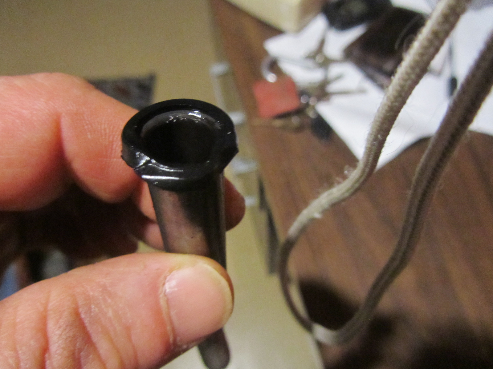

The hard, deformed plastic at the oil pump end of the oil strainer.
The new strainer arrived, and... that ain't plastic. Well it is now but it used to be rubber. Glad I got the new one. I wonder if oil was seeping around the formerly rubber seal on the old one.

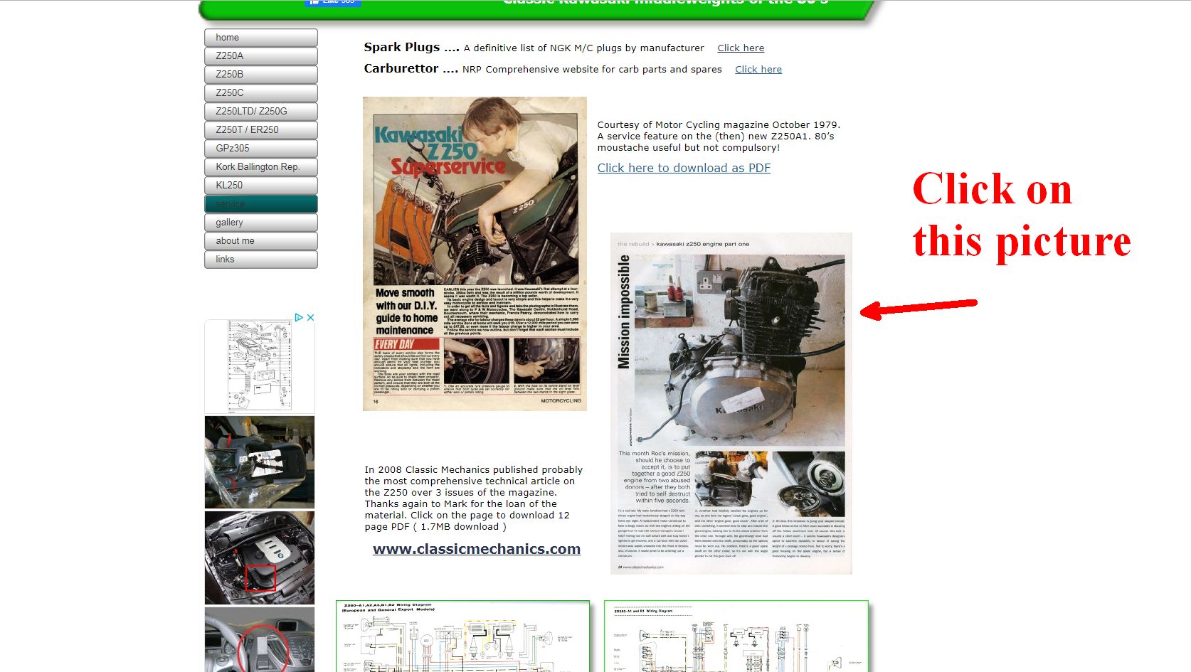

27 May 2021 19:33Great news - I found a mention with some photos of the blanking plug that causes issues. z250.co.uk/service.html
There's a PDF with some good info. I'm not 100% on the location still but with the photos I should be able to find it...and it seems it may be doable without splitting the cases.
Where's that pdf? I can't download it now. I probably won't need it but I'd like to look at it.

27 May 2021 20:54Great news - I found a mention with some photos of the blanking plug that causes issues. z250.co.uk/service.html
The "hidden" link to the PDF.
www.z250.co.uk/2008MCM.pdf
