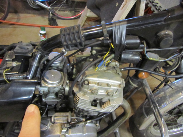

Going boldly where apparently no man has gone before! And if they did, they left no record. Oh my.
Gas tank removed.

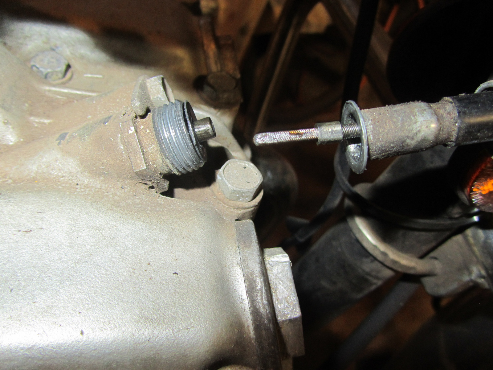

tachometer cable removed. They say you should remove the pinion part from the head cover too before installing, but I've read that its not necessary too. Anyway I left it in for now.
Removing breaker plate

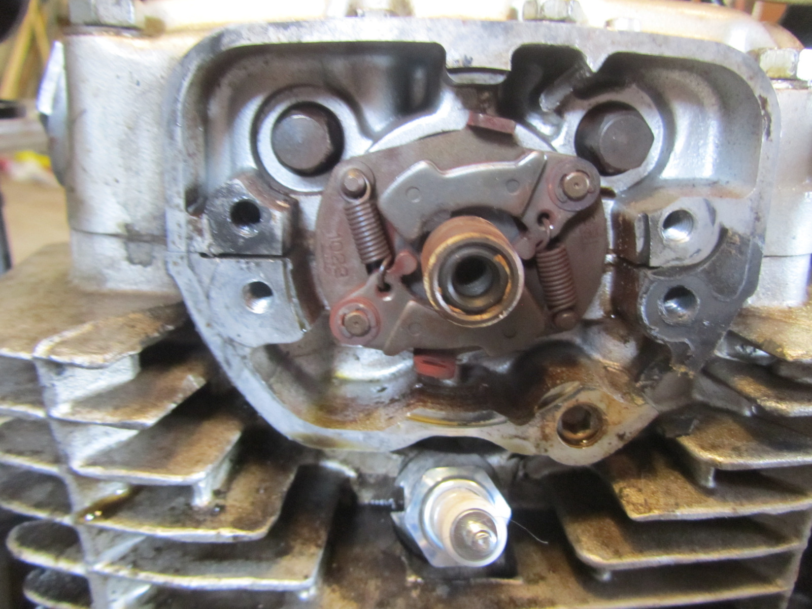

I guess this is the governor. It took me a long time to figure out that it just slides right off the camshaft. Mental note made.
Head/rocker cover off! Thar be ummm... some cammy stuff, Captain!
Inside the cover. The cleanest thing we'll see. The tach pinion that we should remove before reinstalling, supposedly, is just left of center.

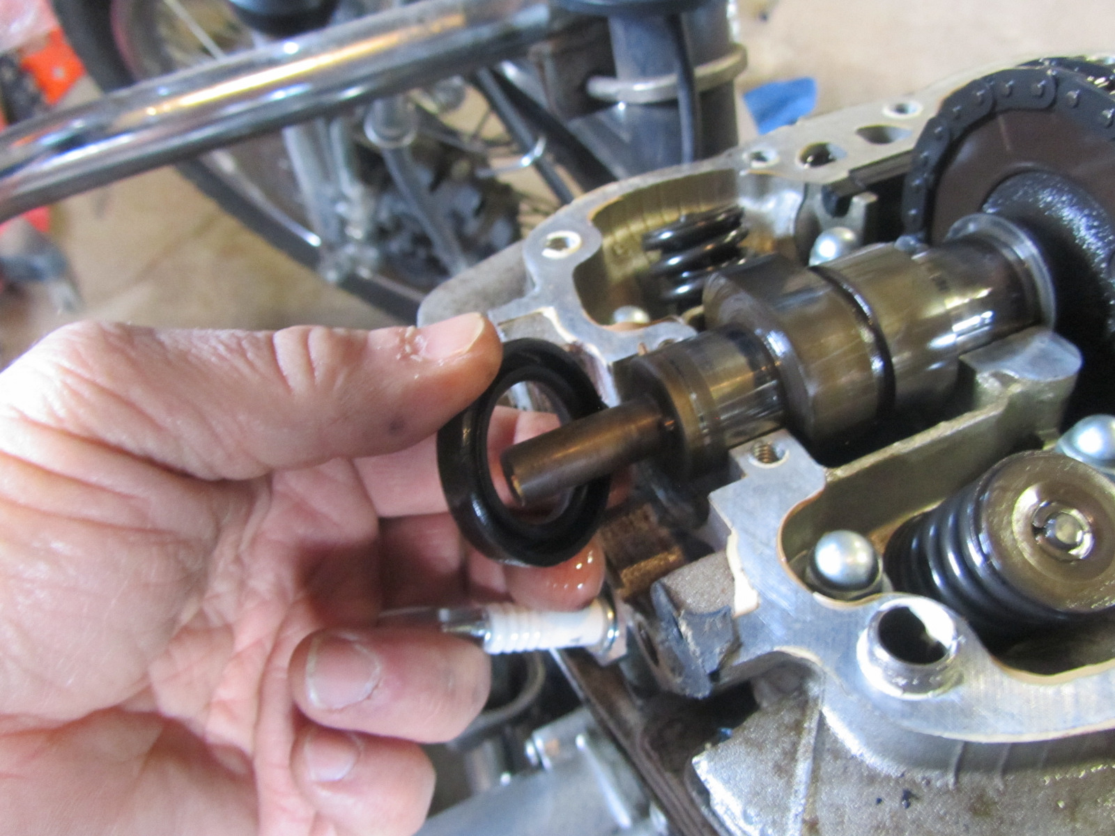

Do not attempt to remove the camshaft oil seal without this "special tool!!"
Gas tank removed.

Guess its better to put my captions below. Valve springs and the 8 head nuts waiting to come off. These are the only things that come off easy. Wire holding up cam chain
The camshaft. You take the 2 bolts out of the sprocket to get it loose, and that gives you slack for getting the chain off of it, which is then engaged with the waiting wire or screwdriver lest it fall deep into the abyss of the crankcase.
Once the head bolts are off (I'm skipping important pictorial steps here, like removing the chain tensioner from the block), lift the head and slide another wire to catch the chain when you remove the first wire...
the head is off and oh, my...that looks not so good to me but fortunately I'm pretty ignorant. Yes I should have cleaned the exterior better, or at all, before removing it so do as I say not as I do. I was very careful not to let anything fall in.
I was expecting the head gasket to look...well, not at all like that.

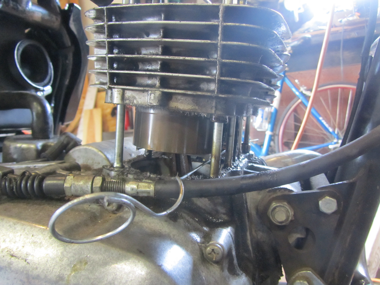

The block comes up. I had to do some prying on this, unlike the head which I just pulled on. Make sure to use the pry points, one on the left and one on the right. Another wire in place to catch the chain again.

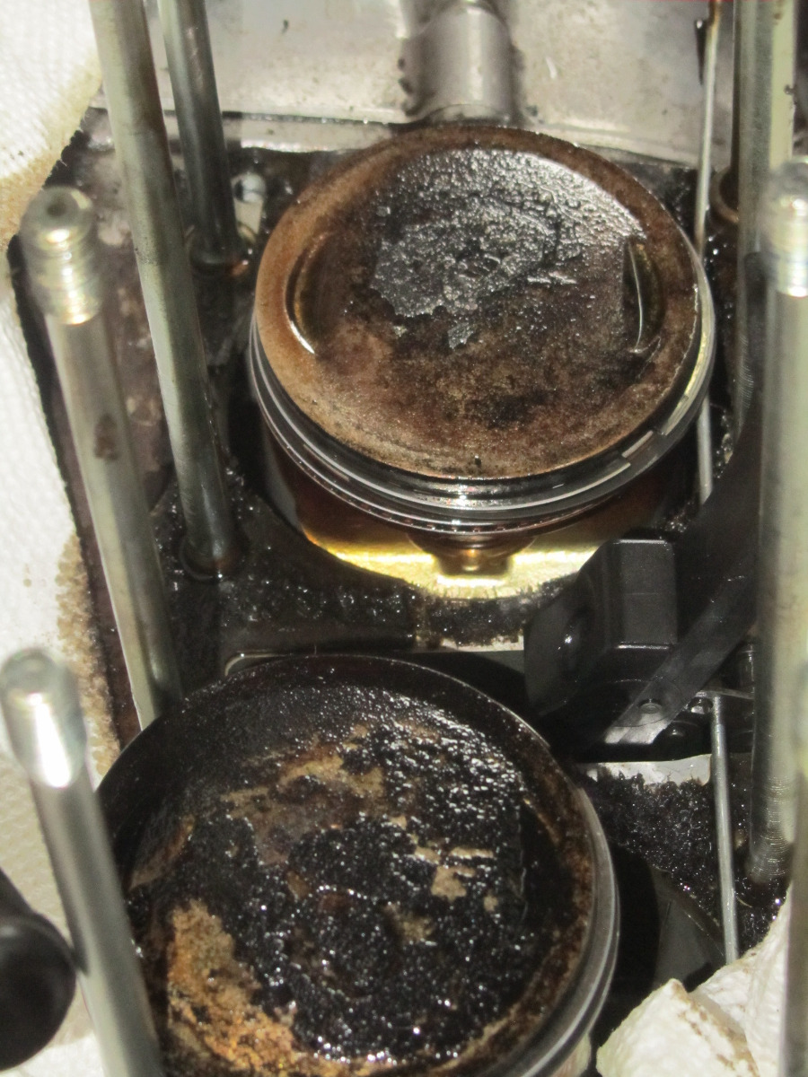

Another look at those pistons...comments?

That scuffed piston seized in the bore. Not good.
- 82KZ305Belt
- Posts: 639
- Thanks: 94
Re: KZ305 Rebuild...attempt

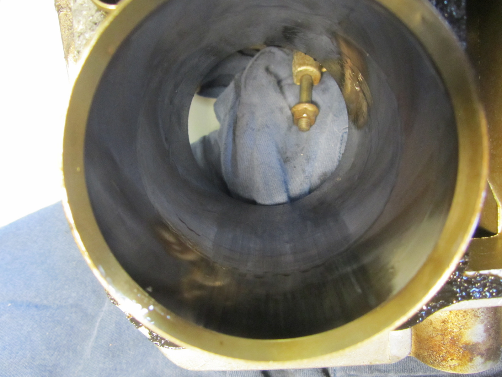

25 Apr 2021 17:58Couple of the valves. Above is the scuffy side, intake valve is the lower one and looks baaaad even to my ignorant eyes.
And the non-scuffed side
Nessism post=847454That scuffed piston seized in the bore. Not good.
If it seized, I never knew I was running on one cylinder. Which is possible, I suppose....

I would say that the damage to the piston/cylinder is not "ideal" but maybe also not "that bad"? I know some will disagree, and I will say that best practice for the most longevity would be boring out (oversized pistons available but probably rare!) or resleeving (yeowch!).
If it passes the fingernail test I would run it - you seem to have gotten it apart pretty easily, another time would be even quicker.
By the way, the wires to catch the cam chain are a stroke of genius...I never thought of that.

That piston is toast, if you are going to reuse it you may as well stop what you're doing now.

I will tackle the evil circlips tomorrow and take the pistons and bores in Tues or Wed. I think the piston might be toast. Its very slight, but I can feel some wear on it. Oh well, I may end up exceeding 305 dollars on this but if I can keep it under 500 it'll be worth it just for the edumacation.
