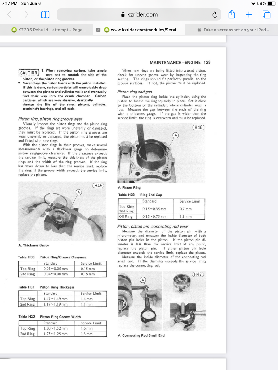

I have no spec to check. I went through every page that mentions pistons and piston rings in my manual.

The ring end gap is listed on page 129 of the factory service manual.

06 Jun 2021 17:30Those gaps are too big. The post above is from the fsm for the 305.Look for a table that has engine wear specs, do you have a pdf file you can share?

I stand corrected , that is some tight tolerances

Well Hot damn, there it is! Now post the index listings for "pistons" and "piston rings" from the manual, because they list a lot of pages for both but neither of them list page 129! I hate this friggin manual, in order to do anything you have to jump from page to page to page, and many of the index entries direct you to a page that just redirects you another page!! It leaves a lot to be desired.
Well under the weight of all this pressure I have no choice but to try and gap them now, but if I somehow mange to succeed without breaking any more I'm inclined to proceed with the old top ring from my good piston on that piston. I've already dumped enough money into this thing and I just cant swallow paying $50 bucks for one freakin ring. Don't do it, it may ruin my bike, you say. Well there was a pretty good chance I was going to ruin it somehow anyway.
