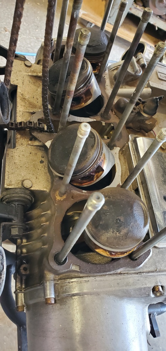

I am working with my nephew on this 95 KZ100P that he got as a basket case and we are working on reassembling the engine that the previous owner took apart for some unknown reason. We are trying to get this old crankcase gasket off in order to install the new one, but I swear this stuff has become permanently chemically bonded with the surrounding aluminum. Does anyone have an suggestions on how to get it off? I've tried scraping it with a scraper, soaking it with acetone, heating it with a blow torch (and worrying that I'm going to do more damage to the case than I'd like to). I'm pretty much to the point of praying to the engine gods that it'll just disappear, but I'm not really religious so I'm not thinking it will work very well.

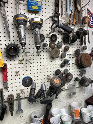

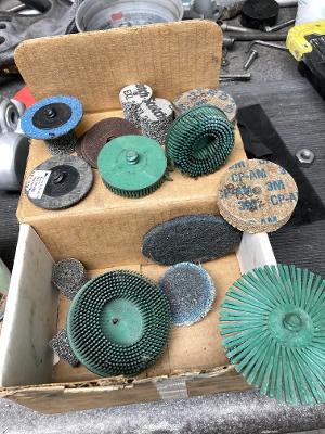

I would take the pistons off the rods! stuff rags real snug & tight into crankcase! Give yourself some more working room. The pistons need a cleaning anyway. They could use a glass bead. Clean the ring lands out of carbon.
And a good steady 70-80 CFM and a pile of 1/4" air grinders at up to 20,000 rpm's with plenty of 3M Scotch stuff!
These green nylon bristle wheels are nice and safe, they take off decals, pin stripes and adhesives of of car paint.
Plus I have plastic standard razor blades for your scrapers.
Let me at it! I can clean it!
