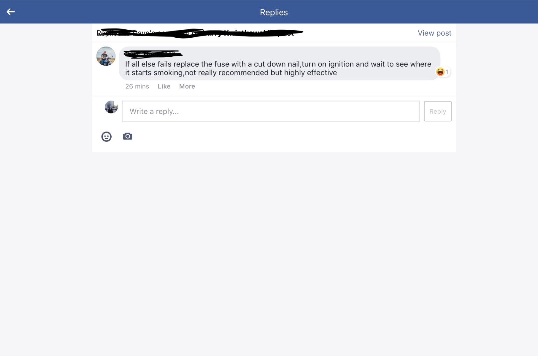

Ok, now that this subject is resolved I think it would be funny to post some of the Facebook “blather”
Heres a reply to a Z1 that started blowing the main 20 amp fuse without any know reason.

My dear old Uncle Stan told me about the "smoke test" 50 years ago, although I don't remember him actually doing it!
He also talked about lighting farts, but I don't remember seeing that attempted either.

15 Apr 2021 13:26 - 15 Apr 2021 13:29Back in the mid '70's I had a few friends that worked at a Buick dealership service department. I would go there and have coffee with them before I would have to go to work. I remember one time one of them was trying to find a short in a brand new Deuce and a Quarter ( Electra 225) He had spent a few hours on it and still could not find the cause of the short. Finally he finally gathered a few other mechanics around parts of the car, bypassed the fuse, turned on the power, and they sat back and waited till there was a cloud of smoke coming from a certain part of the car. FOUND IT!!!!! He than replaced the melted wires, and sent the car on it way!!!!
