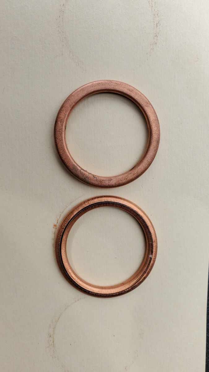

I'm switching out my old OEM exhaust for a better OEM set today. The Exhaust gaskets (11009-1906) have a flat side and a beveled side. Does the flat side go toward the head? Also, any trick to removing the old ones, or just pry them out with a small slotted screwdriver?

The beveled side with the seam goes toward the head. Your removal method sounds like mine.

A dental hook did the removing job for me. It´s your choice witch side you put in first. The gasket will be crunched and seal any ways. Clean all sealing surfacese from carbon and use some grease to "glue" the gaskets during the header installation. It will save your day and multiple attemps.

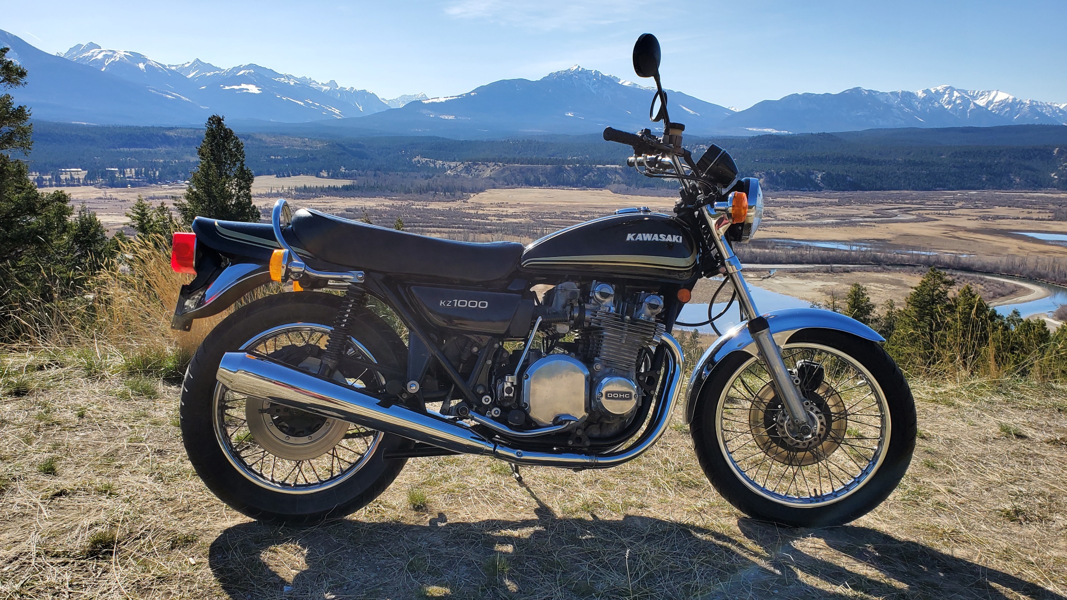

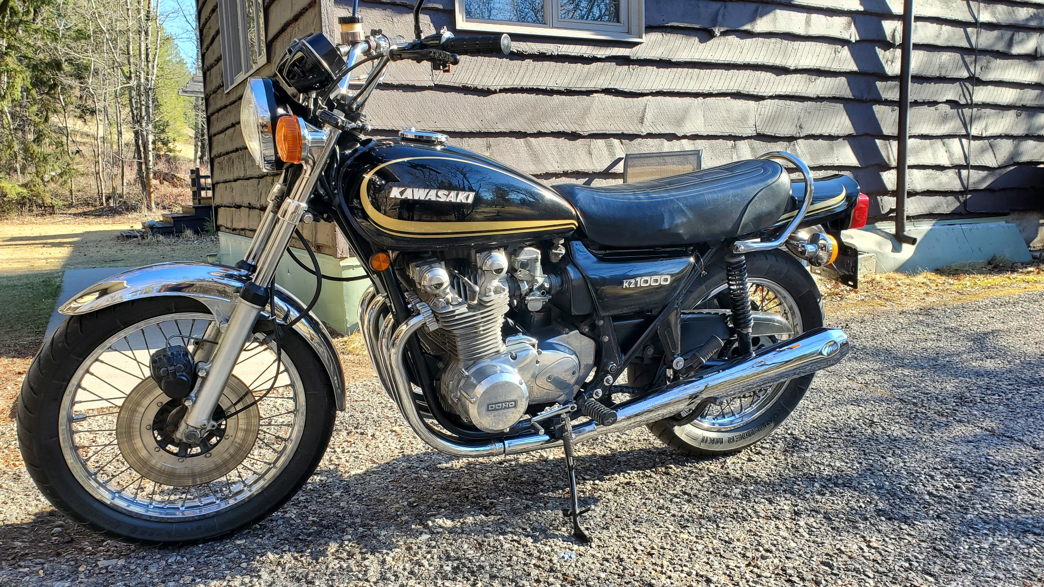

Went on well and works great with no leaks! Seems like a decent performance boost and quite a bit quieter. Not easy to find OEM for '77-'78, as that was the only year for these.

Looks great. I’ve always likes that exhaust design. I’d love to find a nice set.

I'm always keeping an eye on eBay for a set, knowing how hard they are to find. That's how I found this set a couple of years ago. I was fortunate that they were fairly local to me, in Calgary at The Old Motorcycle Shop. They needed a good cleaning, but were priced accordingly ($250 IIRC) and cleaned up much nicer than I expected. The only problem is that they have a very prominent 1.5 inch dent on the left side flair, near the back. That's going to take some getting used to! For now, all of my pictures will be from the right side,
