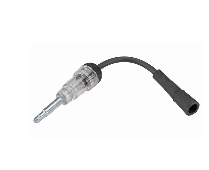

Check the condition of the right side spark plug wire. Double-check that the spark isn't escaping via a cracked wire.
Grab an inline spark checker.
This will tell you if you are getting spark on that right side cable.
Harbor freight has them for $5, but you may not even live on this continent.
www.harborfreight.com/in-line-spark-checker-63590.html
There could be many reasons why that cylinder is not firing.
We'll try to help you figure it out.
