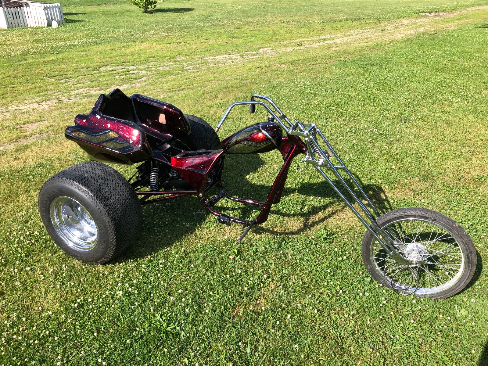

Hello again, More specs for my build now
1974 Z1 cases
Welded kz 1000 crank(my thoughts are the larger rolling mass of a 1000 crank will not rev as fast but will have more of a PULL at lower RPM)
Ape studs everywhere,Ape main cap
Backcut trans with billet 2nd gear
HD chain,all new internal rubber,seals etc
72mm wiseco kit 10.5:1
Stock head (full rebuild)
I now have 3 questions now that I'm typing this out(slowly).
#1 will a slider clutch aid in having a more tunable takeoff (Heavy tire mass at a stop is really got my head going)
#2 If I still need a Drag(wheelie bar), do you racers recommend a 2 or 1 wheel set up?
#3 is actually a carb question should I just grab some Rs34 for this girl or rebuild the 26mm mikuni? I love the old look, but for what this girl should be able to do Im leaning towards the 34s for performance. I will make a new custom style Henry Abe cover if I go with the Rs carbs .(maybe make a stamp set so I can reproduce them(simple design).
Thank you for any input... Be Well!

Looking Great !!!!!
Your trike is only going to be so fast with all that mass, and rolling mass of tires.
I would go stock 26 mm. Which will be snappy down low especially with stock head. . When my bike was stock with 26mm's I was faster up to 60 mph than 28s
Heavy clutch springs with a APE pusher bearing and shifter bushing .
No wheelie bar will be needed , but would look cool as hell. ( Looks only )
See you soon
See you soon
