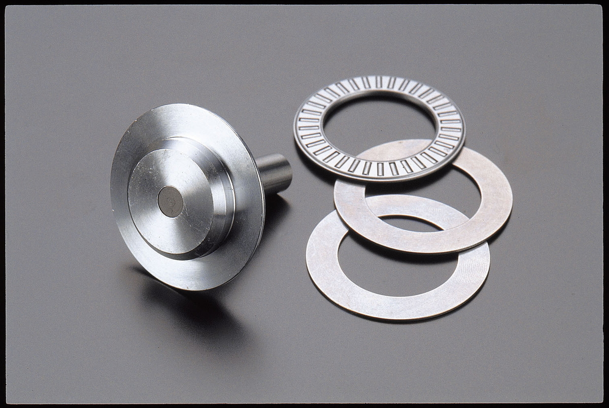

You can't beat O.E.M. fiber and steel clutch plates. Just add a set of H/D clutch springs and a needle bearing clutch pusher to those O.E.M. clutch plates and clutch cable. You can't get a better clutch for your bike. Period!!!!!!! Your '80 model should have the nice clutch release with all the little ball bearings. So you won't need that.

Yes I meant APE , for some reason all their part #s are APC..
So oem over APE heavy duty?
Z1 has the oem but not APE in stock so that's good, just need to find the APE roller somewhere else.

You could just buy the APE needle bearing pusher from, um, APE.
kzzone.com/clutches.html

Went all stock with the clutch, plates and springs. Got the ape roller.
Its soaking in oil waiting for me to install it.
I hate ordering parts from 10 different places. Especially when I have to pay for shipping on one small part.
