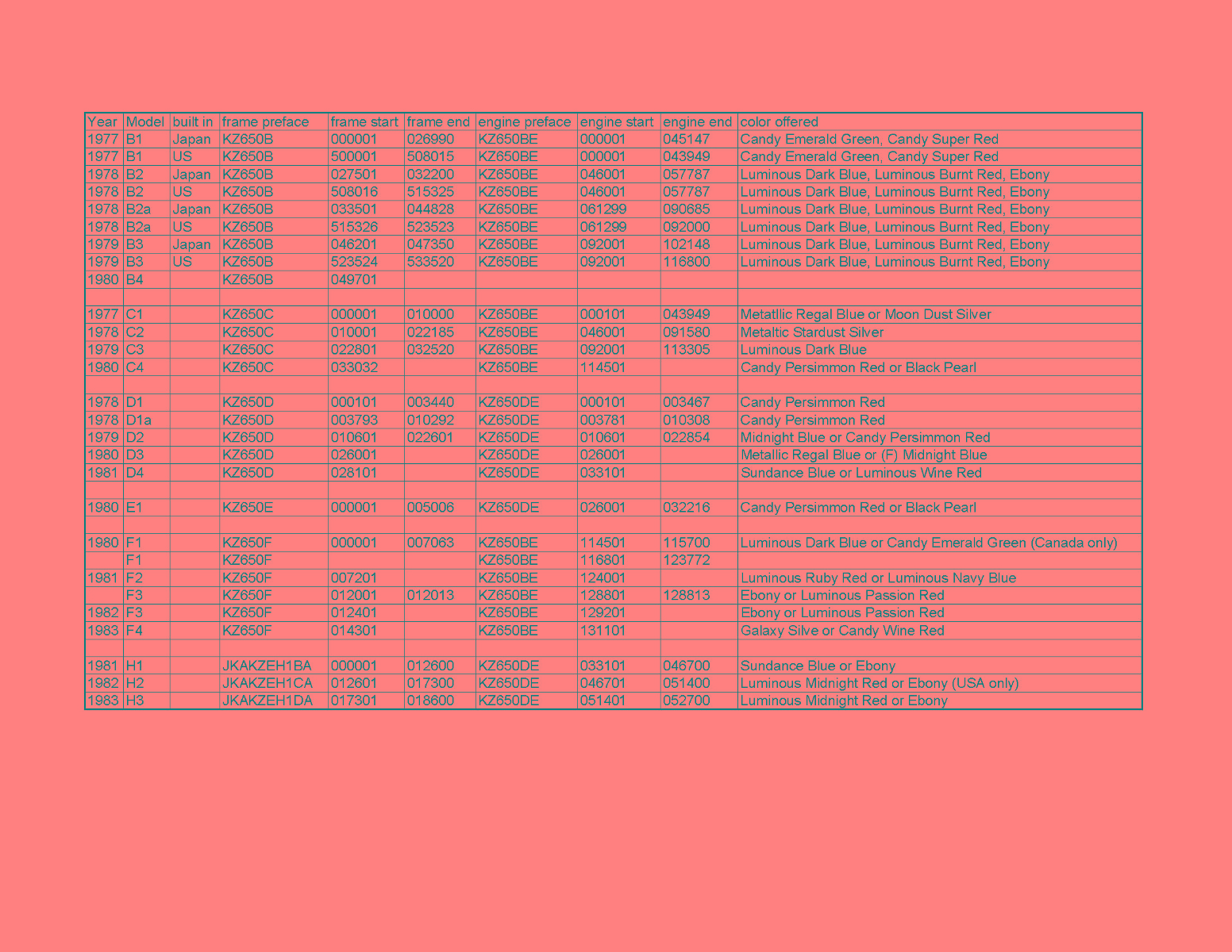

Hi I m new to site. I have a 1979 kz650be and want swap out my engine block with that of the same year and size . My engine no. Is kz650be103613 and the new is kz650be117007. Will this be compatible?

Here are the frame and engine numbers I could find and make sense of. Keep in mind I am not claiming this is 100% correct, rather what I could find and make sense of.
1977 KZ650 B1

Yes, one KZ650B engine can be swapped for another KZ650B engine.

Staying with the same year engine is the smartest idea. The problem with using an engine of a different year is that the charging systems changed a few times throughout the KZ650 models, so there can be a compatibility problem as far as the charging systems are concerned. Ed
