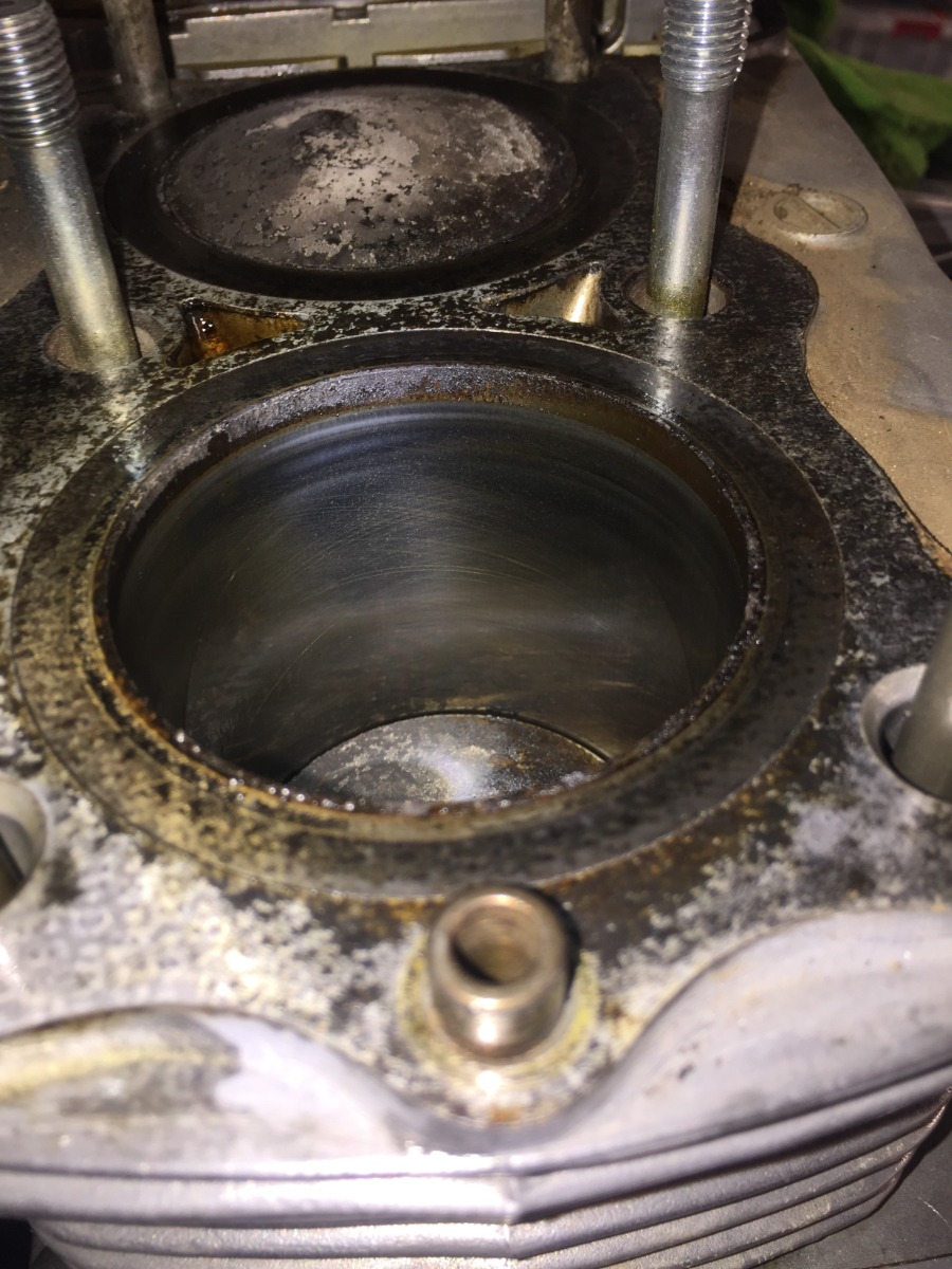

I checked the rings, pistons and cylinders. All were within spec so I put them back together the way they came apart and did not hone the cylinders. I noticed on the cylinder walls scoring from the original honing back in the day. Bike has 34k miles. You can see the honing in this photo.
