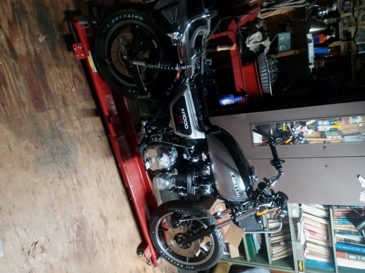

- ronnieV
- Posts: 491
- Thanks: 590
Re: painting cylinder wall and head KZ1000.
12 Dec 2020 06:00
- ken19
- Posts: 57
- Thanks: 4
12 Dec 2020 08:25
@Ronnie
Beautiful,,, Do you ever take it outside! .. /s

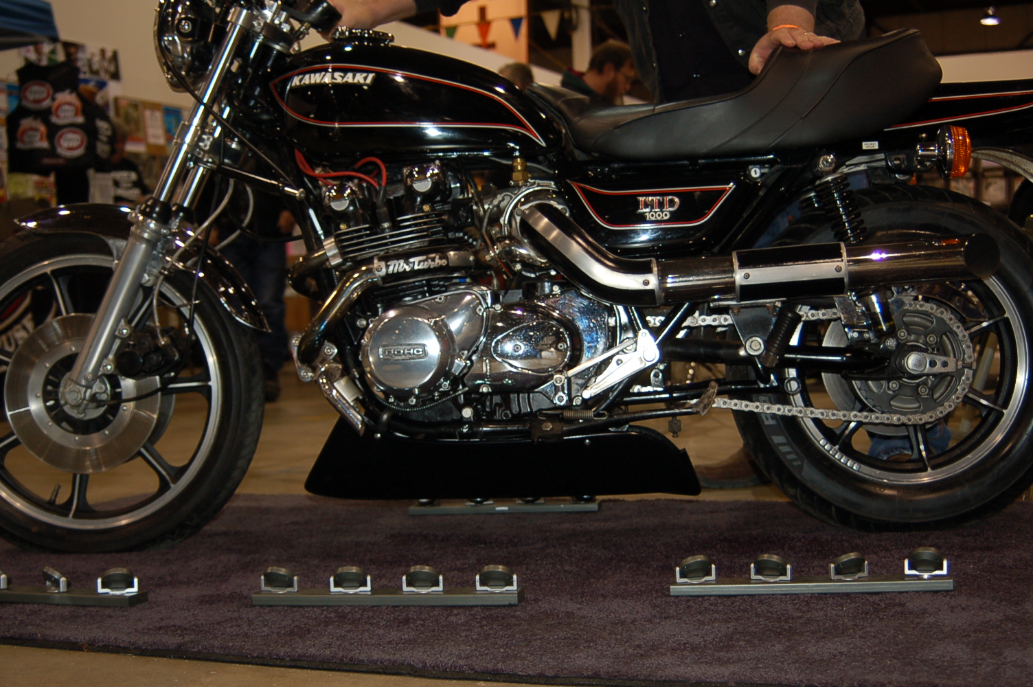

12 Dec 2020 17:31
Dave, Yes it did. That’s one of the nicest photos of you bike I have seen.
