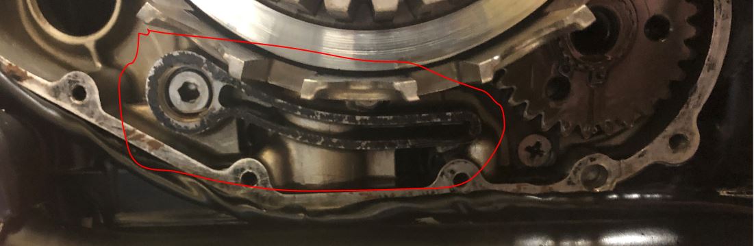

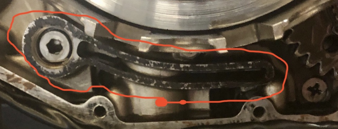

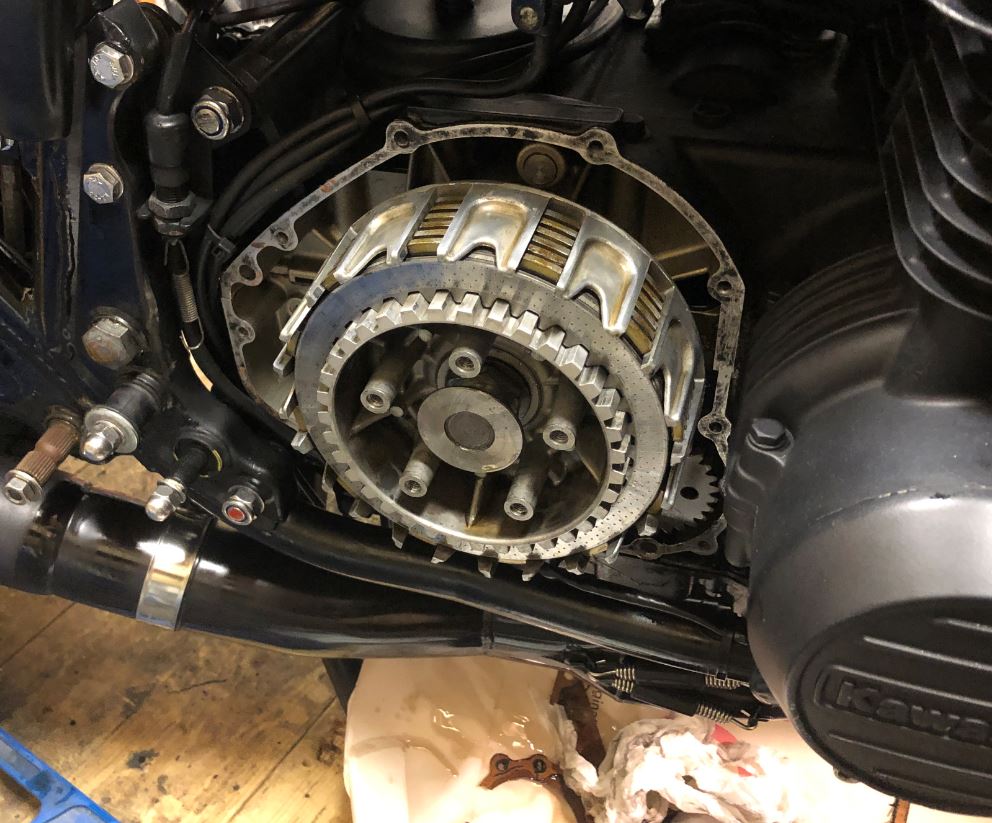

Today have I stared to overhaul the clutch, new friction plates and springs.
I have some questions releated to these, shall their be a gasket in indicated area in red on the photo below?
These is the "channel" where the oil flow to the oil level mirror.

- Posts: 8403
Re: Clutch overhaul
09 Dec 2020 11:53
The gasket goes all the way around the perimeter, but does not stick up far enough to impede the oil.

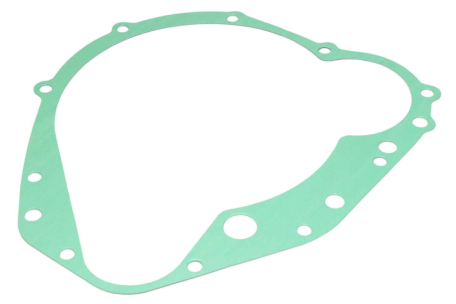

- zed1015
- Posts: 3362
- Thanks: 2072
Re: Clutch overhaul
09 Dec 2020 14:36
Yes! a gasket goes there but it isn't separate .
It's part of the main clutch cover gasket as can be seen below.
- gordone
- Posts: 1538
- Thanks: 93
Re: Clutch overhaul
09 Dec 2020 21:39
aha!
Then I understood what you meant TexasKZ, sorry....
