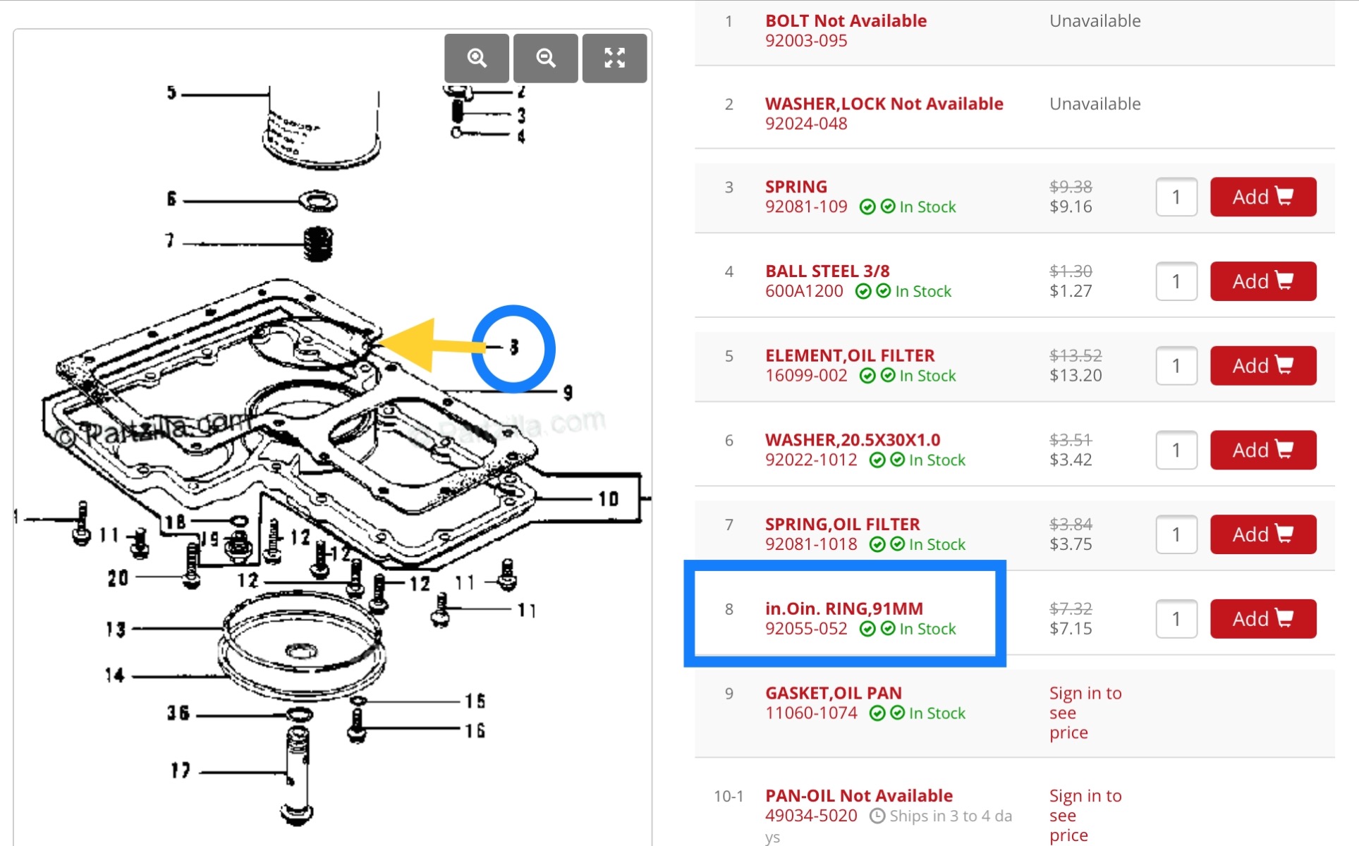

ken19 wrote: Breather Cover / Oil Pan. Damn! I saw Breather Cover and skipped right by it. I'm an old man,,, so there's that!
How in the hell did I miss that! What can I say..... lol.
Thanks anyhow.
The breather cover is on the top case. If your talking about between the lower case and pan see marked up screen shot.
