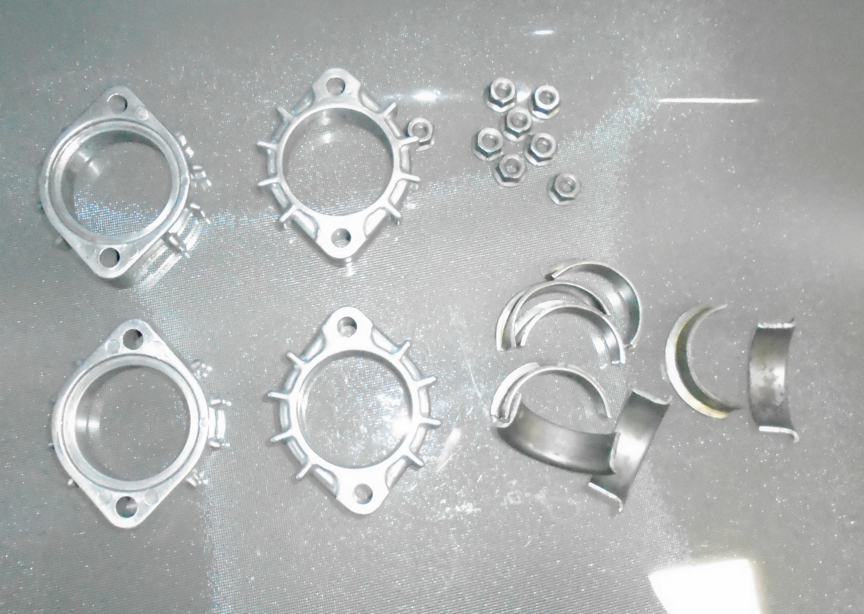

Yea'; stuff is always strange? I don't know KZ 650's Except they changed over to CSR about 80-81? But look what no one wanted to pay $30 bucks for? I had these listed for over 30 days. I don't get it? Not that I care? I did give them to a memeber on this forum that bought the exhaust pipes. Just making a post. If these were Z1 or KZ OEM? would have been a $100 faster than the Roadrunner messing with Wyle E Coyote!
Happy Thanksgiving Day America!
