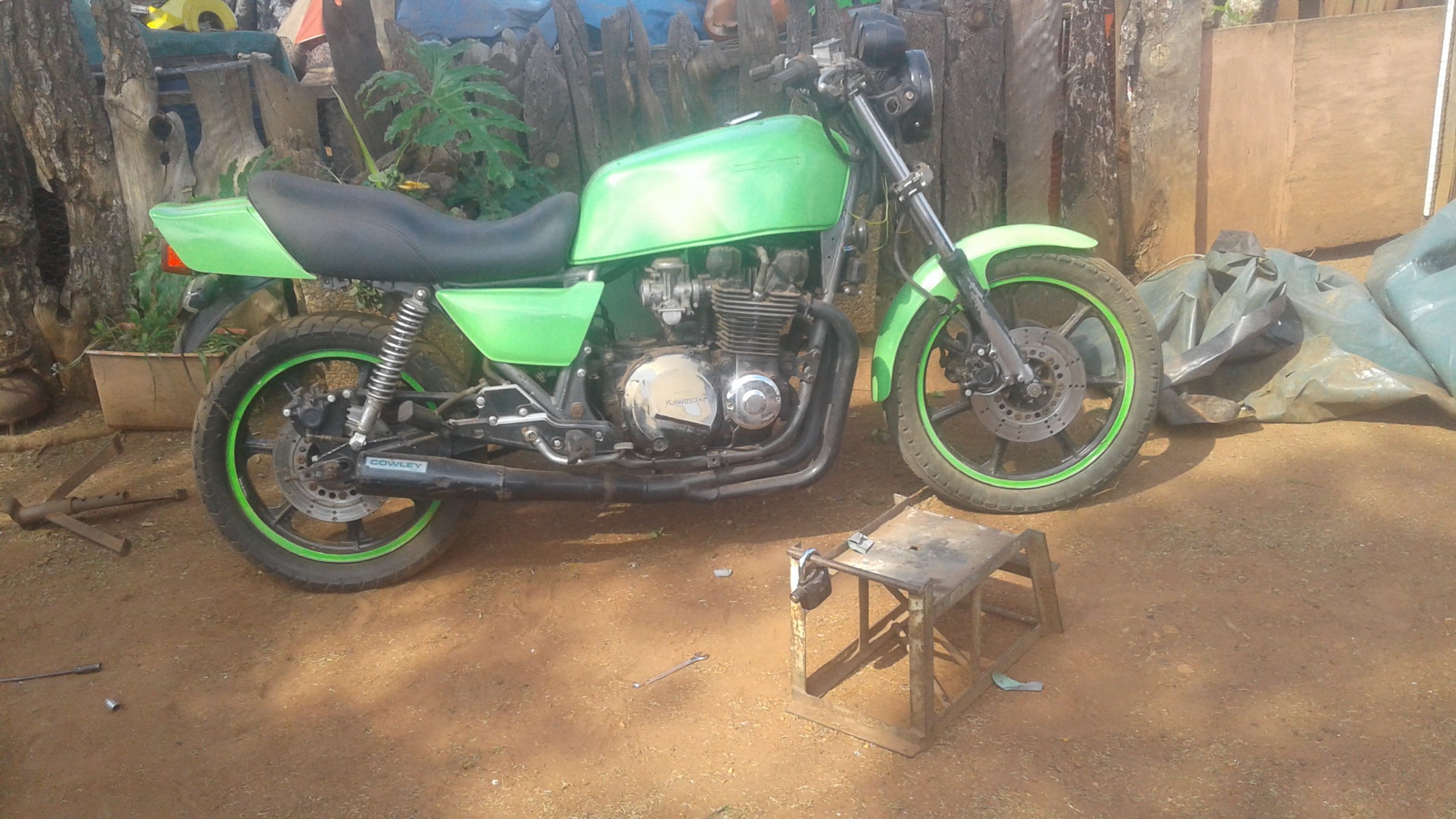

i recently bought my first kz1000j
i want to know what is the best size exhaust headers to use on my bike according to the previous owner the headers that is on the bike is to small id(inner diameter ) so i want to upgrade the exhaust system while i am busy restoring the bike.
the bike currently has a cowley exhaust with headers not sure about the current size have not yet removed the exhaust to see what the id on the headers ,i first want to know what size wil be the best for performance so that i know if i take it off i am going to replace the system or not photos of the bike is uploaded with my post

Based on what I can see in the picture, if it were mine, I would restore that system and love it.

25 Oct 2020 05:01TexasKZ wrote: Based on what I can see in the picture, if it were mine, I would restore that system and love it.
I agree. Sandblasting followed by ceramic coating would be sweet. Hopefully it's not all bashed up on the bottom.
Our KZ's are 40 years old these days, trying to squeeze out every last bit of horsepower from them is a poor value proposition.
